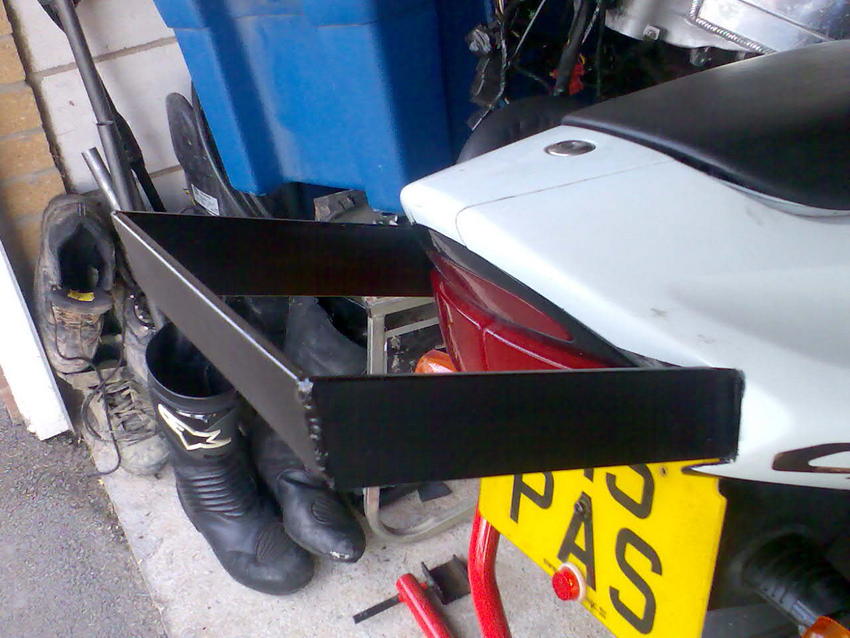

Marks out of ten please
My first go at a 12 bar:YEAH
What do you think

Re: Marks out of ten please
looks good, maybe a gusset on each side of the inside of the contact plate.
Good start mate:YEAH
it looks good, just shorten it up. the tip of your tail is almost straight up 12 so that is way too long
thats a 10 bar looks good tho
^^ I did think that I used a dry wall square to get the angle but the lenght i was not sure,
Put a thin crossbar where you have the little plates. Shorter and put on another scrape plate like the ones that come with US bars
yeah like ghostie said. Might be a good idear to put clamps around the back end of the bar aswell give it more ridgity and def a wear plate on the back. But def shorten it to just past the tail.

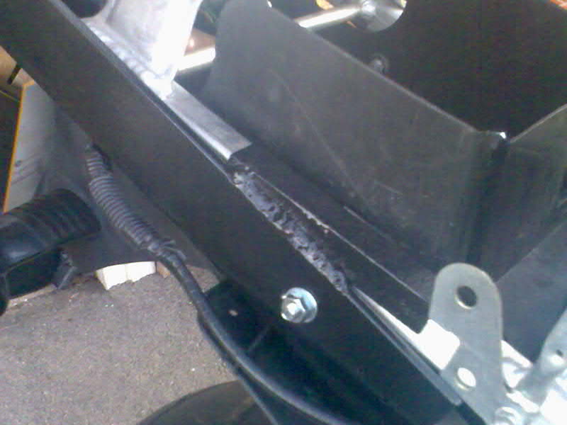

looks good for starter
not sure if u have more but I could only see 1 bolt per side?? I'd recommend adding 1 or 2 more on each side.
but I like the extra right angle bit welded on
+1 on the length and wear plate - but I'd still be inclined to try scrape it :YEAH

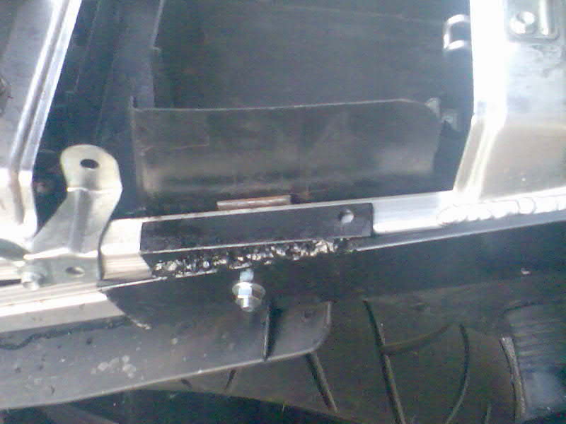

Nick There is 5" of angle iron top and bottom so there is no movement up or down with out the bolts in, but Im going to put a few more in any way thanks.
How far should the plate be away from the rear light?? anyone..
inch at most
When we made my 12 bar a few of us lifted the bike up into the 12 position. I sat on it and we clamped the bar in place exactly where I wanted it then just welded it up. I'll admit my bar is quite long but I'm just getting started. I used some nylon as a scrape plate if you like and its worn down nicely.
angle iron's a good idea
yeah I wouldn't worry too much about length just now as u say ur learning - but if u do make it shorter u might wanna make sure u can still stick a toe or 2 or the gap between the bar and tail section
that is a weak bar...sorry man but i have a short bar like that just for standing in and its fine for that but once i scrape it my subframe bends immediately...and my frame is steel tubing....i think aly wil crack...i had a longer bar wich was mounted all allong the subframe all the way upto the main frame...that never bent...and i scraped it all the time and crashed it plenty
i dont mean to hate or anythin, but i think itll save you allot of repairs if you strenghten it
also (youre gettin it now :P) i make my bars slightly higher than the seat/plastics...saves them when you crash...and its a bit long....right up to against he lights is more like it
