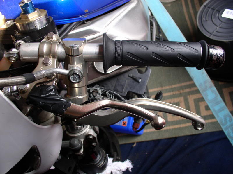

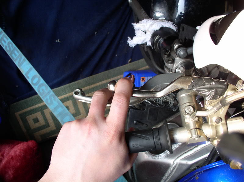

Old Apr 7, 2007 | 12:56 PM
Sparks!'s Avatar
Posts: 3,983
From: England, UK
Sparks! is an unknown quantity at this point
Re: Handbrake set up and creaking..?
Hi Lee, I re-done mine this morning and its exactly the same as yours, well, my fingers on the HB are a bit closer to the master, but I don't have a radial so can't move the clutch any closer like on yours.
I just rode down the road at 30mph, pulled clutch in and managed to lock the rear wheel with the HB with clutch in.. so I think this set up is fairly good.. can't wait to try it out on the back wheel :YEAH
I need to get a radial like yours then it'll fit up better.. but this'll have to do for the time being.
