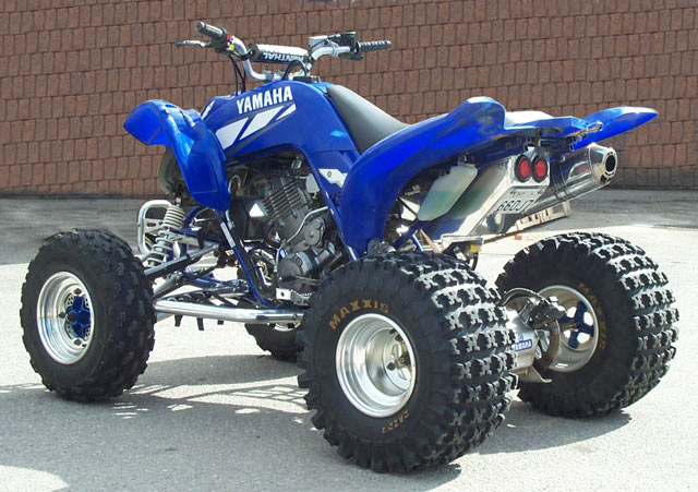

I've never seen a Sport Quad with Air suspension, But yeah I agree I used to have a Raptor before I picked up my 270R..and I made up a complete Aluminum Undertail...here's a pic...it does allow you to put more pressure on the carbs....I do miss the Raptor for wheelies though cause the 270R is so stretched & widened that it's just for pure race now.

nice....both of them. What made you decide to do the undertail?

I dunno it just came to me one day..lol, And I wanted to get rid of that stupid push on gasket filter & I wasn't happy with the Flange pro-design kit so I made it all polished aluminum from the carbs back & the whole battery Box....It looks pretty crazy when I get some reduced pics up I'll post some more so you can check it out..I am selling them on my site www.Atvjunkies.com. but haven't gotten around to finallizing any paper work to go with them..instructions etc......I just liked the look.
