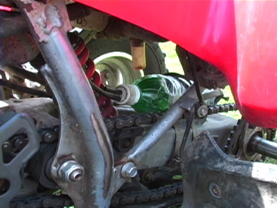

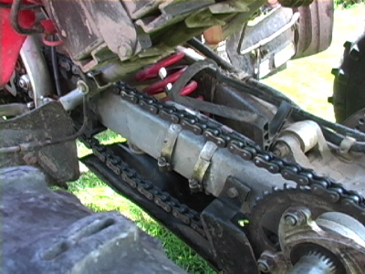

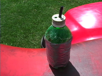

So when I first got my quad I noticed It was leaking gas like a motherfu(ker, when ever in a wheelie of course. I figure this something to do with the carb so it doesn't flood out. So what I did was buy a 2 dollar water bottle holder, got a 20 oz of mountain dew and two hose clamps. With that I Attached the bottle holder to the swing arm with the hose clamps, as far from the chain as I could get. Then I just drilled two small holes in the mountain dew bottle cap, one for the fuel to come in and one for a vent, and I used a little bit of hose that I had left over to make the vent hole up a little higher so it could hold more gas. Now I can ride for about 10 mins or so of pure wheelies before I just slide it out of the holder take off the cap and pour it back in, saves me a hell of alot of gas. Later on I put some duct tape around the bottle to make it a little tighter in there that way I can jump and it doesn't move.
