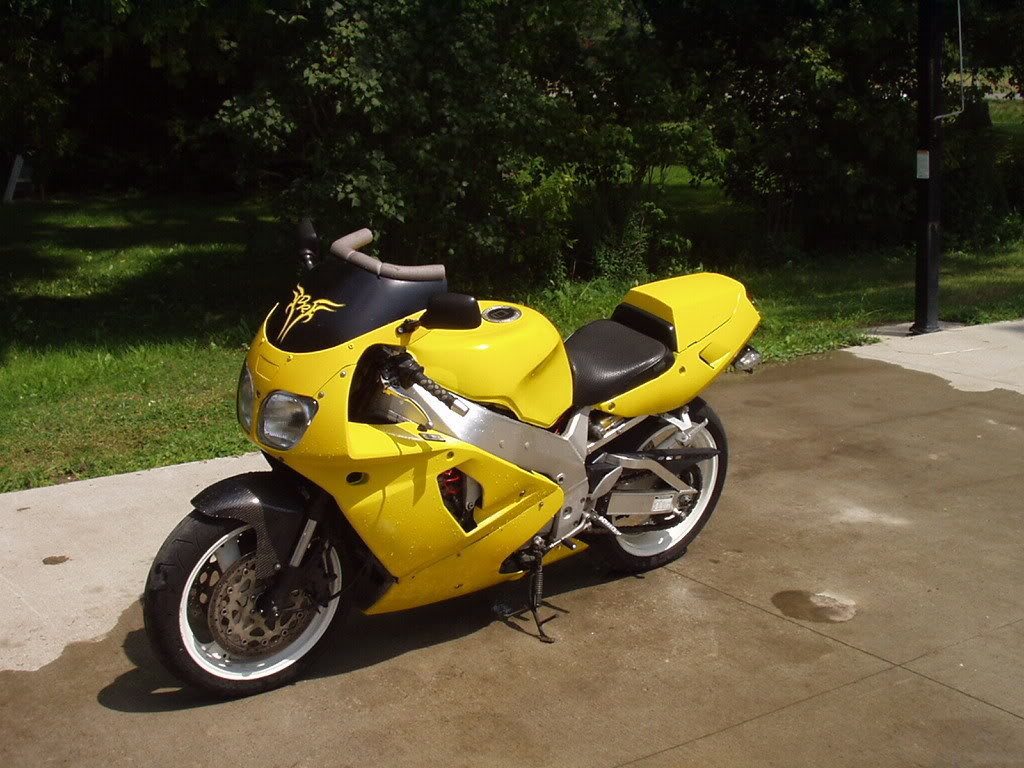

done with fusion... not bad for a rattlecan...
it was pretty durable, and some friends of mine did their fiddy plastics and they seem to be holding up pretty well...
That being said, I still would be wary of painting quad plastics...
