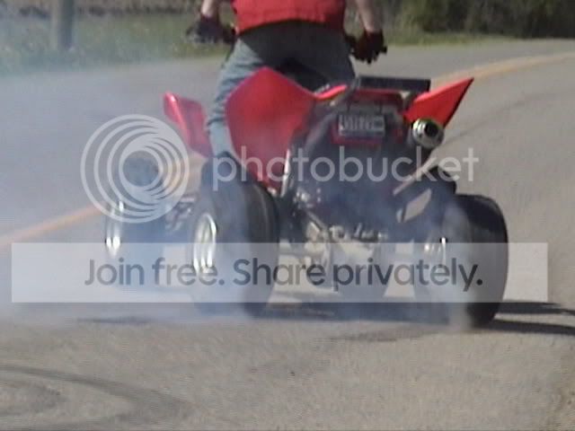

R6 12 bars are a perfect fit on the new Honda 450r. I didnt ask him what year the bar is for but I will come back and let you know. He had a couple layin around and figured one would fit... He threw it up under the seat and its like it was made for it.
Check it

that's insane.. how flat is the plate at 12 o clock??

look good.
Its not bad.. if you run the bar even with the sub frame, it'll catch the first like 1/2" of the skid plate. Thats my buddy AJ's quad, he did this other kid's quad that was with us yesterday. Same quad and 12 bar, but he brought the scrap plate a little lower so it would grind the whole plate a little more and it worked.
He just drilled 2 holes on each side, the hole farthest back on the subframe where its the thickest near the welds, he ran a tap all the way threw. Came out like butter.. Looks real good
Just thought Id give you guys a heads up

Looks like it would almost sit better at 12 if it were upside down
