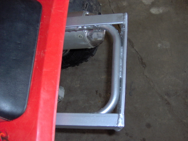

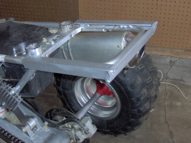

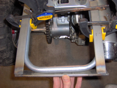

This is how I'm trying to make mine. Different from what I've seen. If it comes out right I'll make a few. I figure it will be strong as hell fit perfect all 400ex just weld it on. It will come all the way to the crossmember and support it there too. I don't know if stainless was the way to go but we'll see. i can cut it off and youll never know it was there if I sell it.

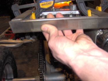

Pic 2 I didn't clamp that straight it lines up.
I hoisted the quad up to the rafters got the angle marked on the correct
side and cut it. I'll weld it up tomorrow. Looks with the seat on.
Those who know this stuff correct me if somthing looks wrong.
Thanks for readin my thread.
Old Apr 9, 2005 | 10:18 AM
Jimmah's Avatar
Posts: 823
From: Manchester, NH
Jimmah is an unknown quantity at this point
Re: My 12 bar
I'm no expert but I have made a few 12 bars in my day and judging from the pics you will crash if you hit that 12 bar in anything above mid 2nd. You have too much of an angle on that plat and it will not scrpae evenly, meaning just the rear of it will scrape. Your gonna want to have at least 80% of that plate scraping. Looks good so far though.

sorry jimmah is right you should take a little angel off that.

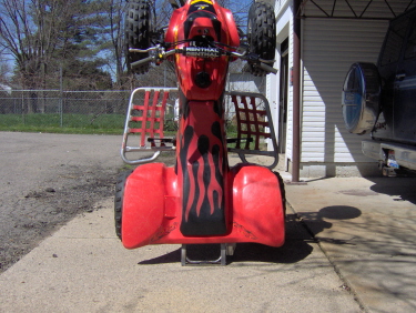

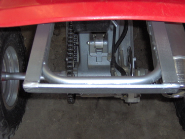

You guy's are right thanks !! ...................DONE!!!!!! :YEAH
I hoysted it and welded it up in the air and got it PERRRRFECT. FLUSH with the level Pavement.
Thanks what you think !!!! :YEAH

maybey put a thicker plate on?

yea, i hafta agree.. once you use it a few times, and you are satisfied with the angle, I think (if i were you) i would weld a bigger plate on it... my ...

I'll have to see how it wears, I'ts pretty thick Stainless. I can always slap another plate on.
I'm going to make a couple more. One for the yellow bike too.
Maybee I'll put a thicker one on the next one.
thanks for the input !!

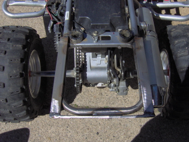

I realy think I'm done with it now. touched it up with a little paint after I went riding this morning.!!
Looks good I think
Thanks again for all the help guys
going to go scrape it up. :YEAH maybee start on another one.

If you're gonna go stainless, might as well do titanium. Just kiddin. Looks good though. Did you mig that or tig? Nice welds too.
Tig......mig..........depresion.....recesion...... I'ts all the same thing
just kidding .........Mig.

looks great! i am making one myself, what angle do you think i should put on the end of it?

measure and weld the whole thing with it hoisted up so you get the angle perrrfect.
It was somewhere around 80
