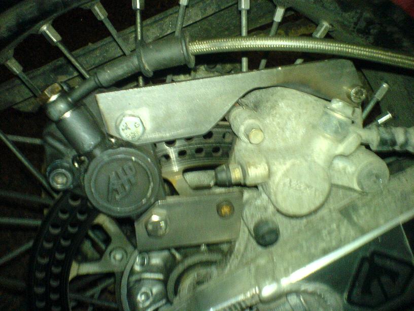

Went to a friend today who had several calipers lying around. He he, 12oclocker you were totally right I didn't expect those front calipers to be that big, never seen them off a bike before, anyway even some small rear calipers didnt fit. Came up with this as a temporary solution, looks like **** I know but it works although I have to squeeze the lever like crazy with my finger . Anyway, going to order a larger caliper tomorow and get myself a nice radial master cylinder, current one takes up too much room on the handlebar,barely room for the clutch(thats why the brake lever is on top, which kinda sucks) . I'll post pics when I got a proper setup, although it won't be as nice as urs
ID:	218510   Click image for larger version

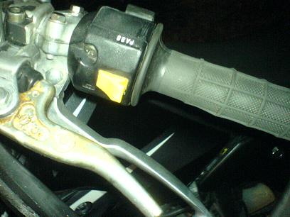

Zarrell that bracket looks dangerous, lol, you know if those brackets even move slightly left or right when you nail the brake and lock your caliper, you could buckle it and snap or bend your rotor.
take of pic of your rear foot master and post it up for me, I may have some ideas for you, also tell me the number on your foot master, it will eithor say "1/2" or "5/8" or "14" or something like that.
since your rear master is rather large, and has the reservoir inlet, you can go with this setup:
call up rekluse, and order a replacement master cylinder lever, the master cylinder lever from them is $60 usd. its a 9.5mm master.
make sure to tell them you already have a rekluse kit, and your master cylinder and lever broke in a wreck.
also order the clutch cap from them, or you could order the easy pull clutch cap from GPtechLLC.
dont order the whole gptech setup, just the clutch cap.
run the full throttle tap to your rear master, and you should be good to go.
the 9.5mm master cylinder will give you the strength you need.
the only thing stronger is the new KTM clutch master which is 9mm, and has integrated hotstart lever which you could use for the clutch.
(ktm clutch master https://www.ktm-parts.com/mm5/mercha...Code=SBBMAGURA its cheaper on ebay, $129 I think)
Lol I know, but it's actually more solid than it looks. I don't get enough pressure with that cylinder to lock the tire at more than like 5mph anyway. This is what my rear master looks like.. but I really wanna go with a dual caliper setup, I already ordered a larger and better caliper which I am convinced will fit, I just need to find a good master cylinder. I emailed Bill at fullthrottleinc, who said they were going to make setups for the DRZ aswell. So I thought I could ask what just the mounting bracket and perhaps a master cylinder would cost, is the one you have a radial master? Because I'll need one to have room for the clutch. About the clutch, I'm going to get a raptor ezpull. Would your idea with the 9mmKTM master and the small clutch be as good as say for example a brembo 16x18 master with an ezpull clutch?
Thanks for the tips
Thanks for the tips
no problem man, that KTM 9mm is going to be way better then the brembo 16x18, the brembo wont work well with a small rear caliper (I know cause I got a brembo 16x18)...
But for your setup, I would go with rekluse master, GPtechLLC ez pull cap, fullthrottleinc superduty adapter tap. or you could wait until bill gets dual caliper brackets made for you bike.
this is the master Im running on my bike right now, its non radial...
