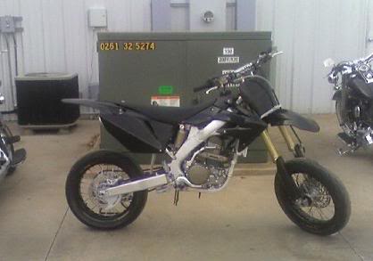

Re: supermoto setup for a crf250
its all good i got some excels w/ powers tires REAL cheap. already swapped em and put on bodywork last night.... cant wait to get this thing broke in! check it
looks SICK.....nice bike but beware, black plastic is very vulnerable
vulnerable toooo?
