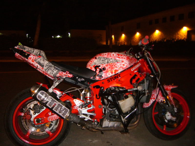

ok first off let me say i know alot of you are gonna hate and say im some spoiled rich kid or something but im not i work 8-5 m-f on other people bikes to get money for my toys.....plus working at a shop and getting a hudge discount doesnt hurt also i have some sick sponsers that really help me out...i would like to thank UDOWN,CYCLEDELIC PAINT,C4 REVOLUTION(GET WELL DAVE!!) AND SIX SIX ONE

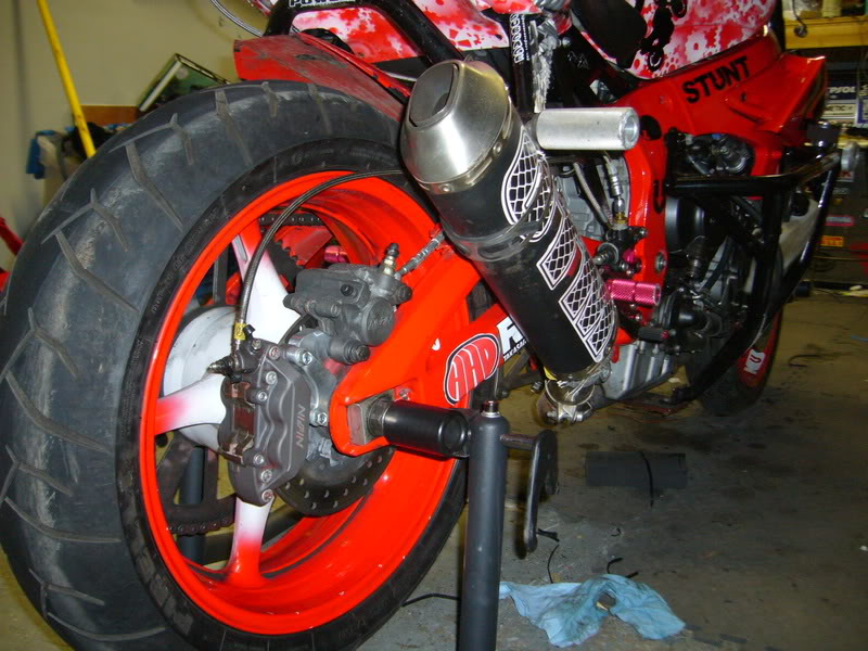

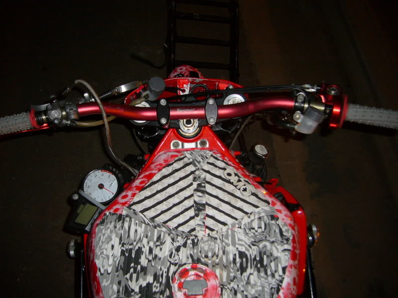

i can tell you i will be changeing the hohey mount to the newer style and also getin some rear sets asap!!! but heres the run down of what im running so far for 09
the bike is a 2004 r6 with 2003 r1 front forks and 2005 gsxr top& bottom tripple clamps fitted with applied billet bar mounts. renthal twin wall bars with the cross bar removed, joker machine billet throttle system with custom throttle cable,a 2005 r1 front brake master, and a brembo 16x18 master for the handbrake , pazzo billet levers(both) . for the clutch i have a moose easy pull lever as well as the moose easy pull pully box system.69 th vortex rear sprocket, powers cage/sub cage, exhust system which i know im the first one to run!!!! , C4 Revolution subframe and mini 12 bar, race tail,ALL brake lines steal braded, house of kolor paint by cycledelic paint, camo stomp grip by paddle board hawaii,......hummmmmm let me think i probly missed a few things here and there just ask if something catchs your eye

yeah i know its hudge but i like the way it looks... i wanted to go 20+ and i like peoples reaction when they see it.....i know i could of changed the front sprocket from stock and got a smaller rear...but i swear i like it.. and how twitchy it is...ive only been stunting for about 8 mth now so i havent even had to change them out yet when i do i might go down a tooth or two

you said you took the cross bar off of the bars, do they flex much or no cuz i have the pro taper ones and debating on doing that. also they look like they are the 7/8 bars.
they are ...there the same size as pro tapers or the renthal fat bars...
they are actually lower and straighter then any pro taper bars..
and renthal says you can run it with or with out the cross bar and these things are made for blitzing whoops so i dont think flew is a problem.......they are soposed to reduce arm pump because of the twin wall design but i cant really tell...i like them alot tho

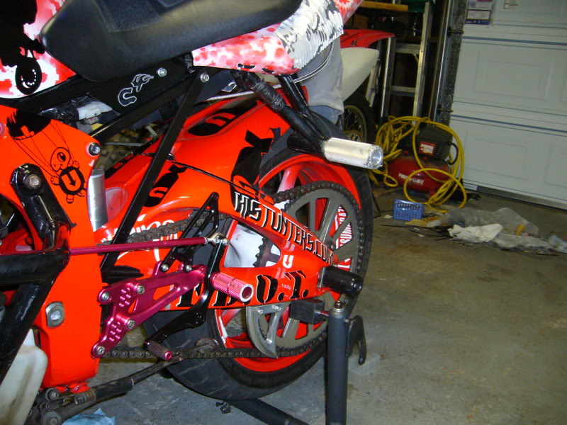

HOHEY DESIGNS 4 PISTON MOUNT!!!!!!!!!!!
ALSO NEW REAR SETS AND I ADDED SOME MORE SUPPORT TO THE SUB AS WELL AS A STEP PLATE IN MY CUTOUT HOLE IN THE TAIL!!!
