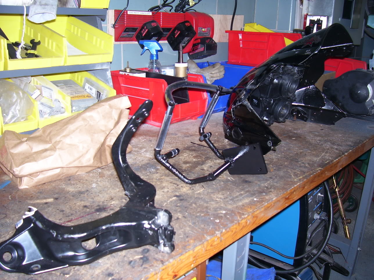

Got Bored, MADE A STAY!
So in an atempt to made a boring night at work. I went ahead and made a fairing stay out of some scrap metal. Note all I hade was 3/4 o my stock stay, front fairing and no bike. Which i was worried about, because i didnt have anything to fit test or refer back too. Turns out when I got home and pu it on. It fit at planned!
If you ar wondering what the clear tubing on the stay is for. Its for vibration and noise... I think I am ging to swap it out for some black tubing though-

looks like it could twist/break at the round/flat weld... I'd throw in a gusset on each side to be safe. Looks good other than that

If/when I make another one I am going to use quality steel instead of scrap. something about pitted steel that really grinds my gears! lol
