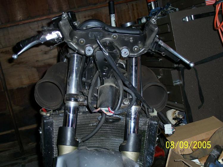

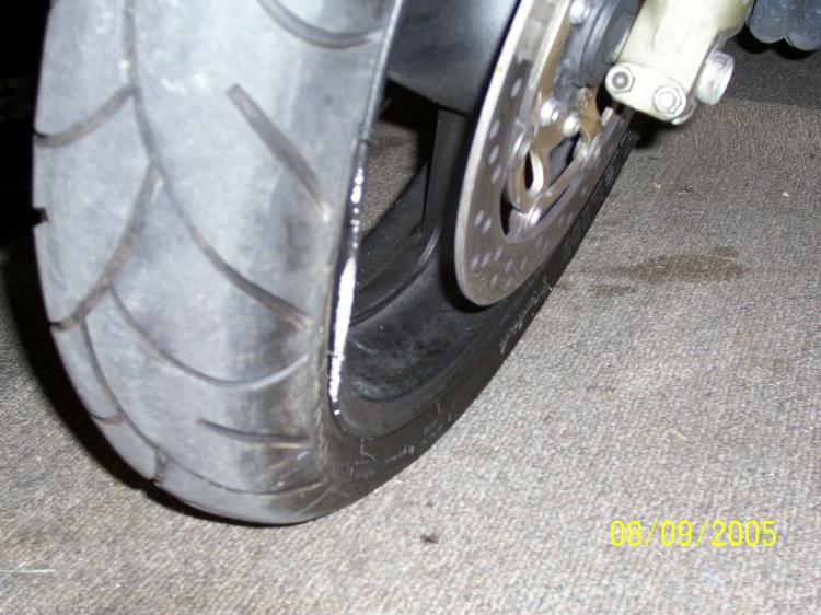

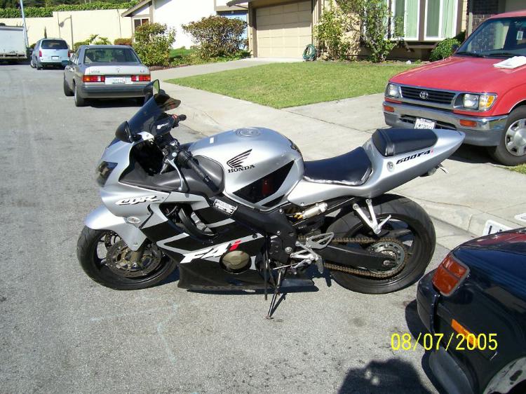

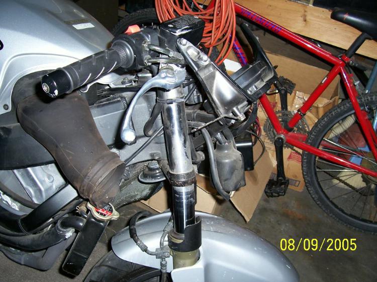

wuddup folks. just picked up my 2nd f4i its a lil crunchy needs forks radiator and rearsets. but **** 2800 for tha b!tch. my minty 03 is all stock pretty much just some visual **** but this ones goin big. wut yall do for yer streetfighter setups...the upper fairing is too messed up to have on. also i think ima order up a +10 sprocket any recomendations?? wut did yall do??
im totally pumped on this clean a$$ deal

not bad if it is a clean title
-2 +10 for sprockets is very nice on the f4i

if ur guan still ride street a lil i'd go +12, and if ur mroe into lots -1+12...get an acerbis headlight, and if the forks are ****ed u might as well caugh up the extra $$ and put a 929/954 front end on it..., shud be good to go after that
deting the tank: start on the edge of the gas cap , place a rubber mallet where u want to hit, hold it there then hit the rubber mallet with a reg hammer.....this way ur not just swinging and ur dents are precise and where u want them to be...good luck

thanks fellas im gettin the forks straightened today!
anybody have a radiator for cheap i can have ups pick it up
