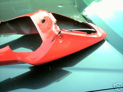

Could anyone do some work on this tail to fix the cracks and mounting locations as well as paint it? Let me know how much.

bondo is easy to learn how to do...painting is another story.

I used "Tiger Hair" to repair mine. It's a fiberglass mixed in resin. All you need is some hardener and about 30-60 minutes to let it set, and just like bondo, you gotta sand it down. Does really good work, and I think it's a little stronger than bondo. Groove out the cracks and weak areas, then make some cross cut channels to also put the tiger hair in. Make sure you make it thick, you can always sand it down.

is that just the one crack? i got fiberglass... looks like an ez fix. take closeups of all the stuff that needs repair.

Noi, it needs more than just some tlc

hit up keith (lou_brakant) - he can plastic weld that shiat up..
