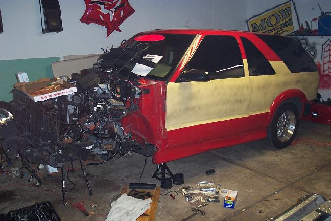

I have them, and Im going to put them on the ranger

Now comes the hard part remembering where it all goes, and how to fit in the pizza...

Holy sh*t you leased that truck If you were gonna chop it up and customize it why didn't you just buy it? Now they are really gonna bend you over for the buyout cause they know you cant turn it in. Oh well either way it'll look when its done.

So you know for later on down the road. A vortec 5.7l from a fullsize will bolt right up. You can use the stock trans and all. All you need is motor mounts, adding a couple wires fofr the extra injectors, and a chip fr the ecu.

Free tip. After pulling the engine, dent in the firewall around where the upper trans/motor bolts are. If you don't know why now, you will after you pull the engine.
