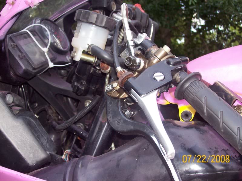

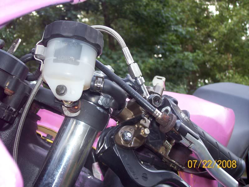

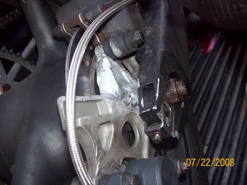

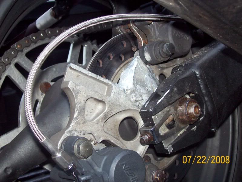

Re: The bullshit thread.
here's the dirtiness.......hate away *******, it works badass....
06 636 radial master, with a (made at a hydraulic place, cause the one i got from hai had been opened and the threads were screwed) brakeline and gangsta mig welded by me and the trusty spoolgun dual-stock caliper bracket

i put my EZPULL on with clutch arm mod and that moose cantilever BS too, one finger clutch all day (not pictured)

holy ****..
i dont see that bracket lasting

i think the bracket is fine....i beveled and welded both sides....not too mention i used 5/8" plate aluminum (6061) for the gusset, i never rode with a HB, kinda different....the 636 master is stronger than i thought it would be.... its only gotta last about a month till i get the hohey order put in....im gettin the triple clamp, dual caliper bracket, and steering damper bracket....btw anyone seen the esd rearset (in person) should i get the hohey rearset and put an esd on it? or get the whole ******* rearset with that short ******* peg? (2.5" i believe)

If you get the hohey get the four piston bracket so that you can run a front caliper for your handbrake. I just switched to the 4 piston bracket and it feels so much better.
thats what i was gonna do....i alreay have some calipers from the 03 600rr front, they are the same as the 929rr calipers (nissin gold 4 piston) i believe

They are the same. I couldn't believe how much better the handbrake felt with the four piston caliper after using the regular rear caliper for so long.
