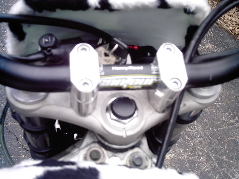

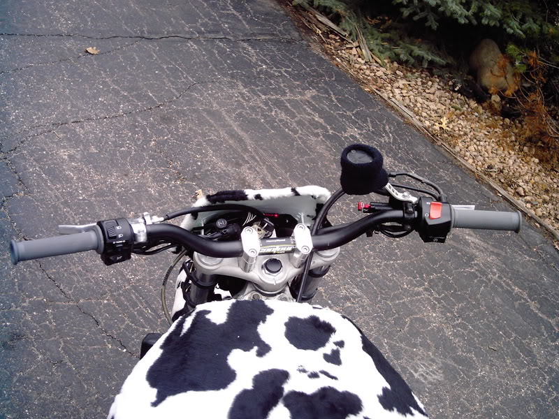

wheelie, what kinda db bar set up is that on the moo cow?
Pro taper Henry/Reed set up..

where'd u get it and how much was the whole setup? cables and all. i want to rebuild a bike within the coming year and i'd like to put db bars on it.

I got the Bars & risers From a guy Here and the cables I got from a
buddies 600RR.. I have $75.00 into them..
I like them alot better than clip ons... :YEAH

how'd u connect the risers to the whatchamacallit? are they just bolted on or welded on?

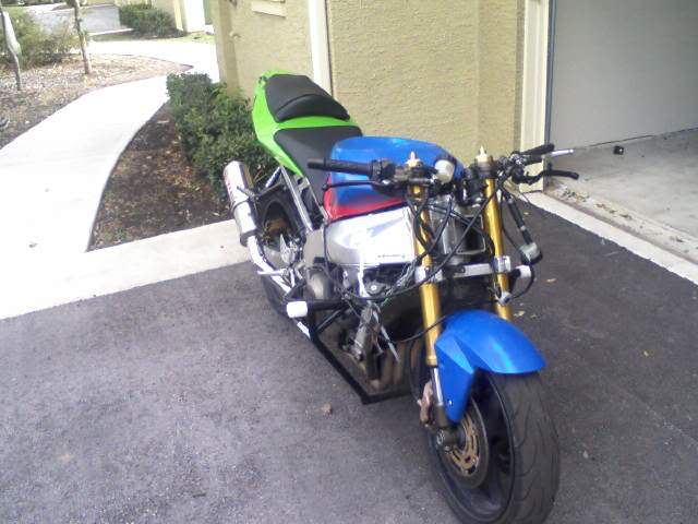

db bars are gay
flipped clipons all the way :YEAH

I took the Top triple off and Fill'd in where the bolt goes thru, then drilled
it and ran a 3/8 x 16 bolt thru. Kinda a bad pic but you might get the Idea..
Buy another top triple off ebay and send it to me and I can do the same for you...
