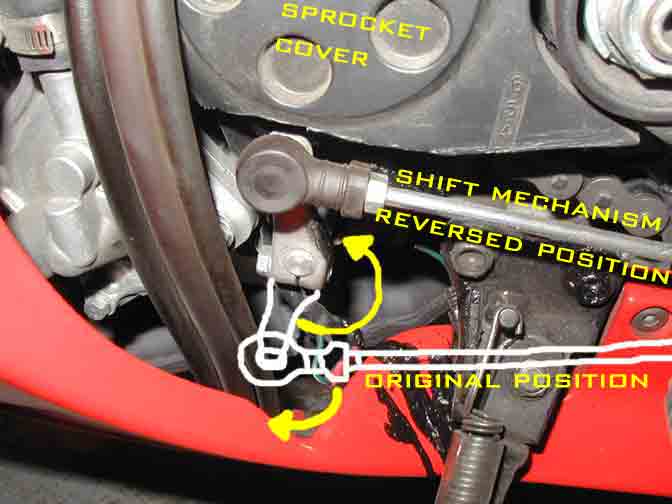

I reverse shifted my 01F4I. After a few weeks of practice my shifting is 100% smoother with no slipups and it feels like its just flat out faster.
Is there anybody else out there that has done this. I would like everybodys take on this modifacation.
(not my bike)
Pic taken from 600ccrule.com

this pic

The reason RACERS use GP shifting is because when they are done apexing a turn and accelerating, they often have to upshift on their way out. With regular shifting pattern, they have to stick their toe under the shift lever. Even with raised rearsets, this means they can easily hit their toe on the ground.
The only benefit for street is a more positive shift because it's easier to mash down then to push up with your toe.
The problem is that it will probably cause you an identity crisis for a while and you're have to THINK about your shifting... which is bad if you want to shift a wheelie. And imagine forgetting that you have to click down instead of up while doing a wheelie to shift... oops, downshift, instant loop.

Just so you guys know, I did not spend any money or buy any parts to do this. I found the information on a site called www.600ccrule.com under bike mods. It doesnt add to the proformance of the bike, it just feels like it does. All you really do is rotate the shifting arm 180 degrees.
