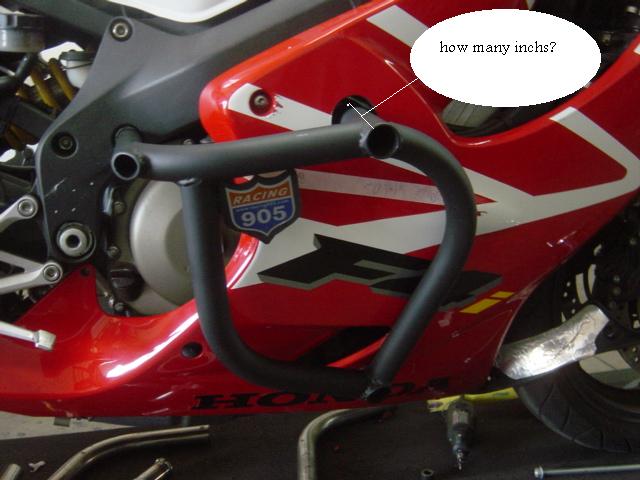

im building my own cage, i bought all the steel and the bolts, one last question before i start building, how many inchs does ur 905 cage stick out of the chasis ?on a 905 cages u dont need sliders on ,is that how they look always?

It sticks out just past the plastics but it's alot easier to just drop the cash and buy one.

my 905 is indestructable....you will rack your shins on it for awhile untill you get use to it, it sticks out around four inches of the frame (gsxr100) not sure how far on the honda

approx 2in from the top motor mount

and ya, you can make one, but it probably won't be as strong as one that's made and tested. and a general rule of thumb, make it long enough to keep the case covers from hitting, and that's it...any longer nad you start getting into leverage problems when you crash.
