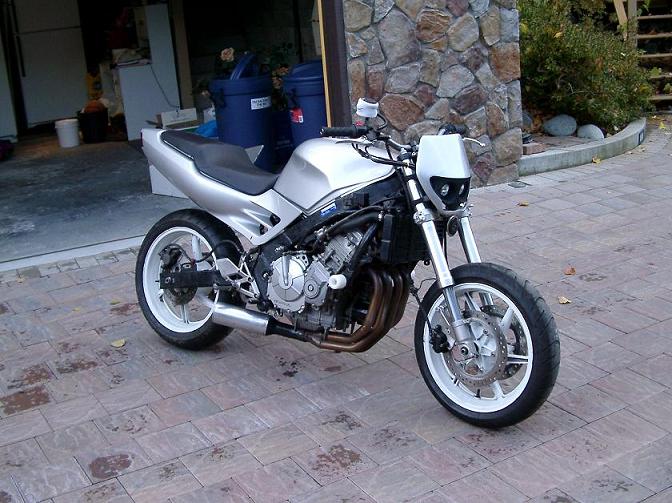

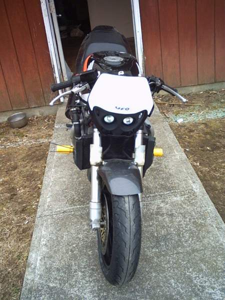

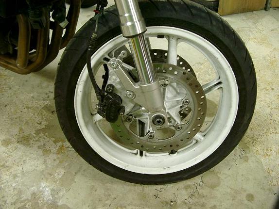

2002 GSXR 750 triple (it's the right width for the calipers/rotors to match up), 97 GSXR 750 forks, Renthal fat-bars (I made the bike for my bro out of my old stunt bike) It's not exactly a direct bolt on... you need to make a spacer above under the top triple (or use a large washer) and then you have to make caliper extensions and use a 900rr axil with custom fittings, but it's not impossible, and the improvements are worth it.
I did id cuz I trashed the stock forks when I looped the bike...
or do the smart thing and just use a GSXR wheel and brakes
