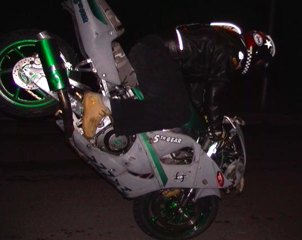

Here's a quick hack of a what a 929 modified for distance stoppies might look like:
- Ahigh
- Ahigh
