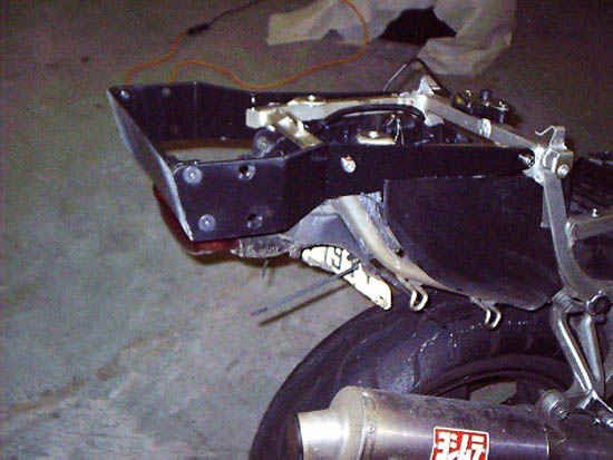

this is a pimp bar that my boy made for me,
Name:	bike&ophelia 002.jpg1.jpg

its for a 99 GSX-R 750.whadda ya think?
Is that adjustable or something? Whats the extra bolt holes for by the plate?
be very careful. That bar is coming out the same angle as me and my boy richies. Problem, at that angle, when you scrape it puts the most amount of leverage on the frame and subframe. Keep a close eye on the tabs coming off your frame where the top subframe bars attach. My boy rich snapped both his off. If you notice, FI bars come out then up, smoothing the angle when you scrape. Doesn't put as much stress on the frame and sub. Thats how my bar comes out, i don't like to scrape though.
