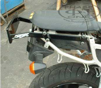

we made our own. Just get steel straping 1/4 inch thick and inch and a 1/4 wide and cut it to you liking and have a friend weld it together and then bolt it on to your bike. Cost.. maybe like 12 bucks. works good. just measure correctly the first time. and bam you got a 12 bar. only draw back is that your neighbors will think you are retarded cuz your bike will be on the 12 bars in the driveway and it doesnt look normal. unless your a stunter.

$80 ... BOLTS to subframe!! powedercoated any color you want

that looks nice, but 80$ GEEZ.
also, i don't like how it has corners and that plate sticking on there.....flip a stoppie and you're done.
i made my own, 1/4" steel, 1.5" wide, 2 bolts on each side to the subframe, and then i cut and welded 1/4" thick, 1.5" wide back plate. cost me 3$ in metal and about 2 hours to build.
we have the process on our website under archives if you want to read, i don't have edges sticking out so it won't stab you if you flip a stoppie.
here is a quick pic
that's before i shortened it, that was about an inch too long.
