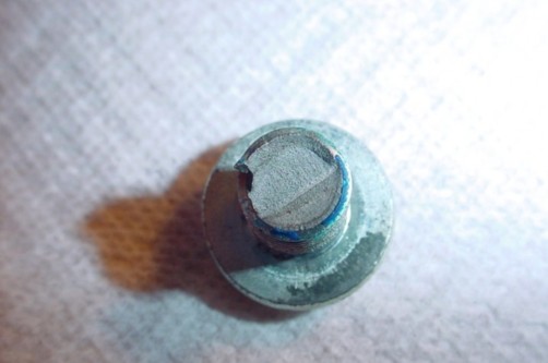

The footpeg: My friends picked it up out of the road and there is not a scratch on it. The interesting thing is this bike was bought new in May. I had close to 6K miles on it when it broke and I wrecked. When you look at the bolt the top 20% is colored differently and you can tell that the crack had been there for some time, for how long I do not know. I would also point out that I learned standups on this bike. For about the first two months I used to bounce the whole bike to get it up, instead of just bouncing front end. This may have contributed. I will never no. I now have new jacket, pants, gloves and boots and new 02 1K. That is my story, be safe out there,
That bolt looks odd, the way it broke. I'll have to keep an eye on mine. Espsecially since I've dropped mine on the left side about a dozen times learning 180 stoppies.

Hmmm with this recent trend of footpegs breaking I'm gonna check mine out when I go through the garage later.
