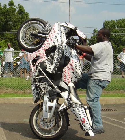

www.undergroundriders.com

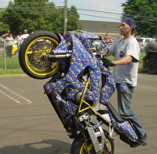

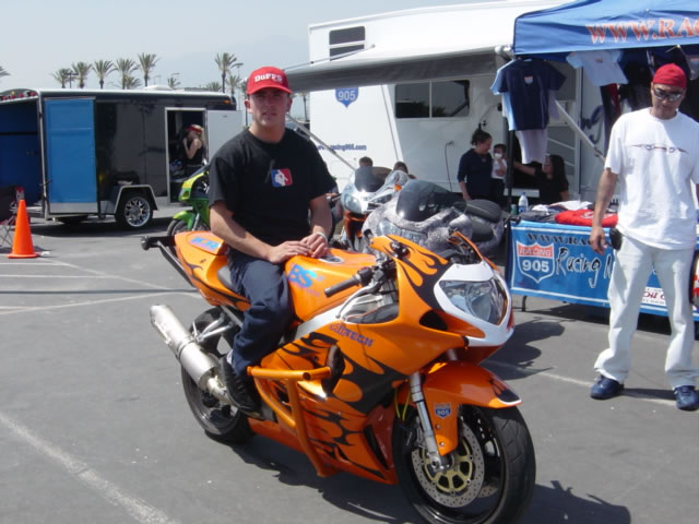

Racing 905

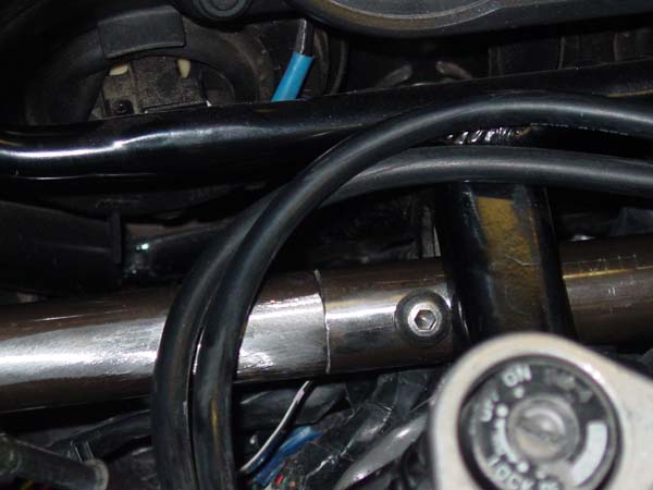

here's the updated version...with the lower hoop going through in front of the motor/behing the header instead of underneath the bike wich used to cause it to scrape.
the upper hoop just has a slip joint with a bolt (not attaches to the bike, so it will not cause damage in a wreck, just prevent it)
the upper was my idea and request upon fabrication of the cage.
this is a racing905 cage made of chromoly...smaller 1" diameter, but same wall thickness....saved the bike from an accidental 50mph+ 12 o'clock crash involving serveral flips and quite a few other low speed crashes.
I am not trying to advertise for anyone, just answering the question...
this cage will not hit the ground in the twisties...or while doing this:
also my 12 o'clock bar sits right behind my taillight, has two holes in it for the light to shine through, bolts to my passenger rear sets and to the mounts for the tail plastic to the subframe, and best of all: is designed to have another plate bolt to it, allowing a variety of plate sizes and keeping the base from being scraped down and needing replacment.

I found a pic of the front:
Old Aug 13, 2003 | 04:10 AM
SIC Nate's Avatar
www.sicriders.com
Posts: 784
From: San Diego, CA
SIC Nate is an unknown quantity at this point
front pic:
