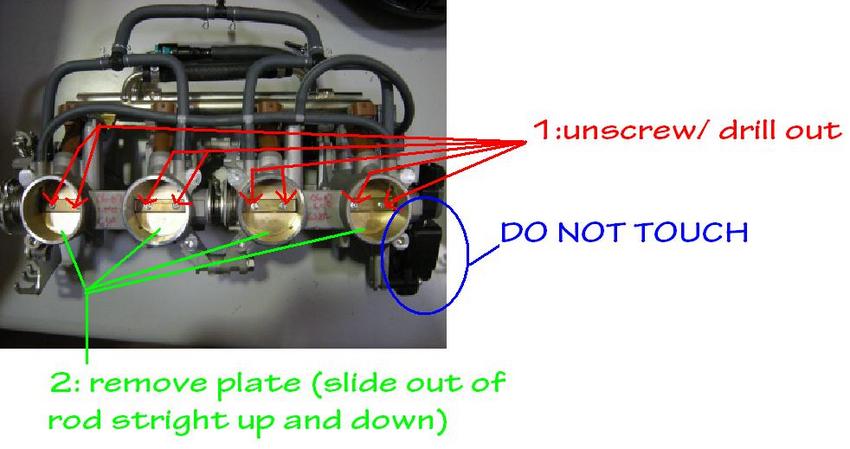

any body have any info how to do the secondary butterfly on a k7 750? where its located and how to do it? any information is appreciated

^^ are you talking about removing the secondaries????

take off airbox, remove throttle bodies, pull the circular discs of the top row (two small phillips screws per plate (for plates total) drill out screws once you strip the little bastards and then put it all back in the bike and GO.
DO NOT REMOVE THE STVA black actuator box when doing this (it is spring loaded and will throw an FI code if fucked with) leave the rod in, just remove the plates. That's it

alright listen i have no idea what any of that stuff is. is there like a step by step i can find? i try and look for info but all i find is forums talking about it.

not that I know of. it's pretty easy though. Here's what I came up with

wheres that bad boy located at on the bike?
lift tank, take off airbox, tada!
