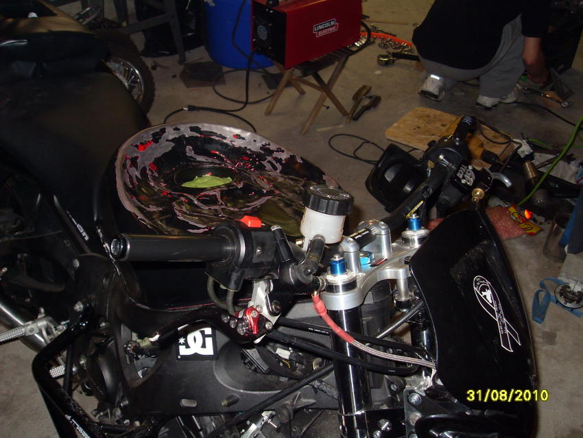

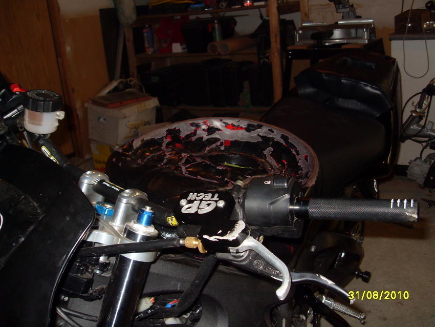

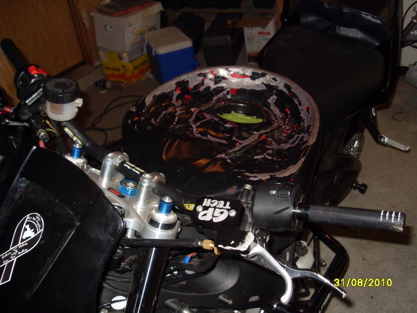

Re: Stunt handle bars for 929?
here are a couple old pics of my r6 with a abm set up.
ID:	241957   Click image for larger version
ID:	241958   Click image for larger version
