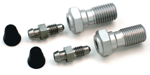

I just started using these banjo bolts on everything, they are hotnesss
http://www.naarden.biz/proddetail.asp?prod=127-03524-11
http://www.naarden.biz/proddetail.asp?prod=127-02695-11
