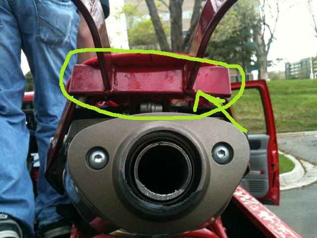

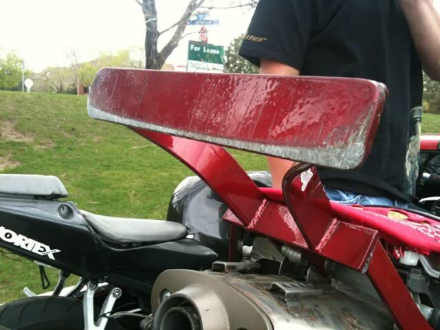

So my sick innovations 12 bar failed on me and i know they will replace it but i dont like the design because its weak and it bends so im asking what other companies make them for my 03 cbr 600rr? and what ones would u recommend? Besides 905, Ive seen what happens to there cages..

so the strap that is circled in green twists which causes it to scrap on the bottom part of the plate so its pulling in the welds instead of sliding if that makes sense ..

Is that a combo bar or a 12 bar
If it's the combo bar, I don't think its meant to be scraped
I don't know what a SI 12 bar and combo bar looks like for your bike, but it doesn't look like a 12 bar since the bar is angled where the front would dig in when you scrape...

that snapped right on the weld, its prob not gonna happen again like that looks like you jus got a defect, **** happens every once in a while....
Towliee im thinkin that is a weird *** lookin 12 bar also, usually it scrapes the top part of the bar an not the bottom

It is there 12 bar not there combo bar, but it scraped flat the first few times i hit it but the strap(circled in green) twisted and it bent way up to where the front was the only thing hitting.. It use to sit right above my exhaust..

dude thats really a 12 bar and not a combo bar?
Why is it angled to the rear doesn't scrape? The rear/upper portion of the bar never hit in the photo, it's never seen the ground.. The front/bottom portion, and about halfway up has hit
You know better then me that ****'s gonna dig in!
edit: I can understand after snapping the weld it's angled up even more.. but you can clearly see in the photo the rear/top portion never hit, the front/bottom portion was hitting first.. Unless it snapped and bent up before it ever scraped haha

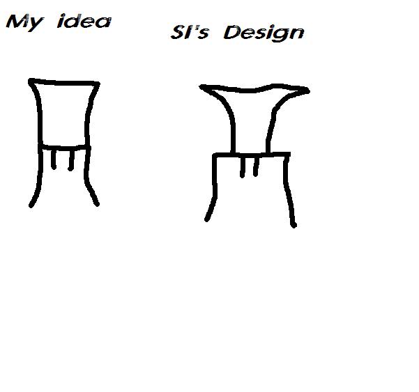

That would be way cool if we could figure something out but i think some gussets would help but i dont think it will fix the problem.. I mean your the fabricator but i was thinking something like this would work the best. I know u were looking to have it come out the taillight hole but its not a big deal to me..
The reason the bar is the way it is verus the way you drew yours is with ours, you dont have to cut the tail. With yours, you would half to hack the tail up real bad. If you would rather one like the one you drew, call the shop and we'll swap you out for one like that. Im not on here much so make sure to call the shop.

The upper rear hit the first time but it bent after that. I rode with it bent for like 2 months before it broke the welds.. But ya it would did in bad!
