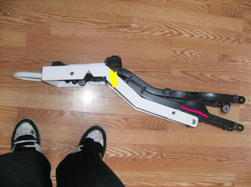

No amount of grinding or drilling was gonna get the right side lined up. It was about half inch off. Everything else lined up good
I know these things are a bitch to get on but it just wasn't gonna fit.
Originally Posted by ATOWN1101
i do make every one on a subframe !! and i do it this way to insure every one will fit with the right amount of grinding of the subframe. i never said it was easy to mount one of these things but when they are on they are worth there weight in gold. i was gona make a bolt together one but i can see it now people not keeping there bolts tight and snap there goes a subframe. and the next thread will be Atowns brace broke my subframe. then ill say your bolts wernt tight and they will be all nuhhhhhughhhh i always check my bolts and bla bla bla. yet they havnt changed there oil in 2 years and. These braces i make are the only ones out with the proper notching for the exaust and even then its still a bitch to put on. i have had so many calls on this thing and walked a bunch of people through it while they bitched and cried but once it was on they love it. hell i had my biggest crier just by another one last week LOL he said he knows what he has to do now he is good. i wasn't even gona sell it to him cause i was gona be up waiting for that midnight phone call how it dont fit
I didn't have a chance to take pics, I will if i remember when i bring it home
Here's a pic I found of prolly your old design but it'll work to explain what was off.
With everything else lined up perfectly (not bolted in, just held in place with c clamp), The right side brace passenger peg holes lined up on that weld where I drew pink line. There's nothing really on that side that it was hitting on, top piece was flat exhaust bolts lined up but side brace was about half inch to high.
On your new braces you have a weld about the place I drew yellow mark I Cut there moved it down and rewelded and it fits great.
It may be possible it got bent in shipping cuz it was sticking out the end of the box when I got it.
I'm not hatin at all. I'd buy another one, I'm happy with it.
