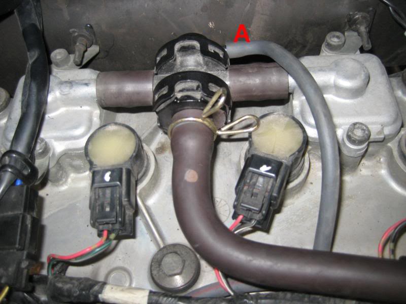

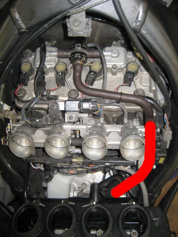

here is the easiest way to do this mod , pics are from lky
join these 2 hoses
unplug and block hose (A)
[i just stuck a long skinny screw in the vacuum line]
block off the holes left in your airbox and you are done ..
