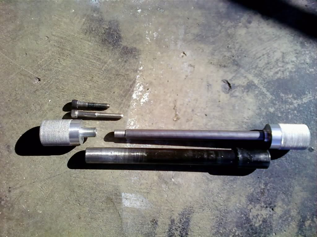

EVERYBODY WHO WILL BE BUYING THESE FOR THE FRONT OF YOUR BIKE WILL NEED TO GET THE NON INVERTED AXLES!!!!!!
the 05 axle has NO HOLE to run through the middle for the sliders....03 and up r6s with STANDARS FORK axle will work!!!!
they are the same thing just the 05 has no hols in the middle!

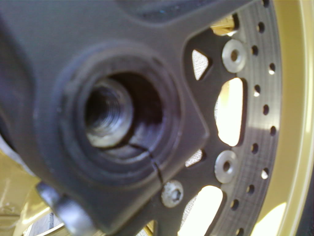

now ian.....heres what i was saying
heres how far its recessed in.....top is with out the slider, bottom is with the slider....look at the distance since the axle is recessed

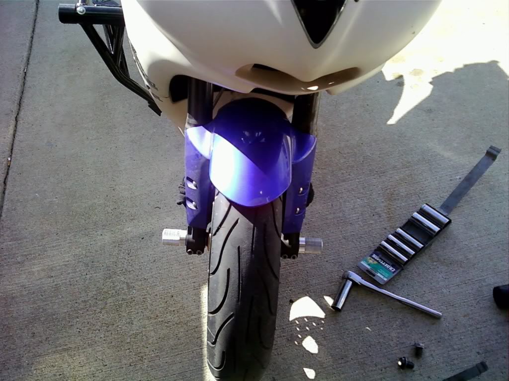

you need a longer bolt for the left side....or a longer axle with the thread in it....heres how is the gap size.....the top bolt is yours, the bottom is what I got to make up for the diffrence. there is about an inch of a gap in between the rod and the peg...
other than these few kinks, badass design man
hope this explained it a little better for ya

Is the axle in the picture a different axle than the one you shipped us?
Old Mar 17, 2010 | 12:15 PM
!!A2K!!'s Avatar
The Reverend Freestyle
Joined: Sep 2008
Posts: 1,845
From: indiana
!!A2K!! will become famous soon enough
Re: SICK r6s axle sliders review!!! PICS!
the black one on the ground is off the 05 front end.....the one on the bike is off an 04 which is the one i sent you
