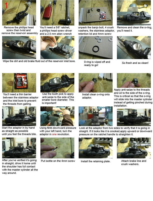

How do i install a full throttle hand brake on a f4i i can't download the link on there page if some1 has a right up that would be dope thanks. ~TIM

Need more deails,like what are you installing???the heavy duty adapter?brackets?bleeding the masters?what
http://fullthrottleinc.net/Product_I...ll_revised.pdf

here it is as an attachment........... double click into a new window annd it should be big enought to read
Name:	honda http---fullthrottleinc.net-Product_Instructions-offset_screw_install_revised.pdf - Adobe R.jpg

Hey hey take it easy im right here So this is the deal i have a full throttle rear hand brake with a brembo master thats going on and f4i my question is that i have this ****** thing that has like a throttle cable running trew it and im not sure how it goes it has like 3 lines coming off of it just tring to figure out how to mount it up sorry i took so long to get back on here. AND FOR EVERY ONE THANKS FOR POSTING UR INPUT UP ON HERE so if u guys can get me some pics and some write up would be sick thansk ~Tim~

I dont see how a radial brembo master will work with a cable system.if possible,I would ditch the cable setup,You should be able to keep your brembo master,then run a 56" steel Braided brake line from the radial brembo thats on your bars/clip-ons to a fullthrottle heavyduty adapter installed into your "stock" rear master.then the stock rear brake line will be relocated to the top of the stock rear master and attach to the rear caliper that your runnin.
