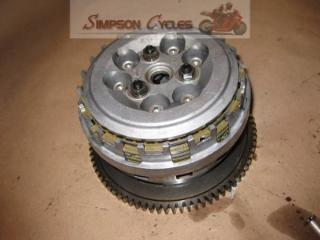

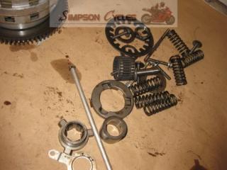

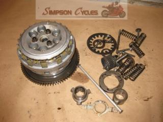

Re: Clutch basket install?
pics...
ID:	235410   Click image for larger version
ID:	235411   Click image for larger version
Old Jan 4, 2010 | 06:36 PM
roadsurfr7's Avatar
Joined: Oct 2008
Posts: 592
From: USA
roadsurfr7 is a splendid one to beholdroadsurfr7 is a splendid one to beholdroadsurfr7 is a splendid one to beholdroadsurfr7 is a splendid one to beholdroadsurfr7 is a splendid one to beholdroadsurfr7 is a splendid one to beholdroadsurfr7 is a splendid one to beholdroadsurfr7 is a splendid one to behold
those pictures dont show me much other than it looks like a GSXR clutch 06+?
I wouldnt replace your basket unless it shows signs of wear. You could be trading it for one in worse condition. and the least the guy could have done was clean the parts and NICELY display them on a clean paper towel.

well its bought, 40 bucks..no biggie. from the pics it looks like all the internals are there.
