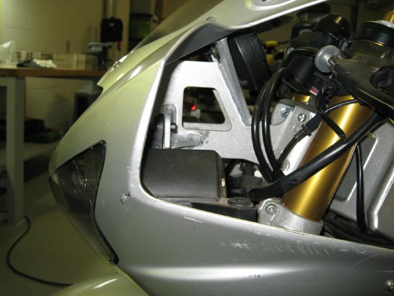

No you dont need the ram air duct, it replaces both the plastic OEM ram air duct and the OEM cast aluminum gauge stay. It bolts to your frame, holds the headlight, the upper, the windscreen and the gauges

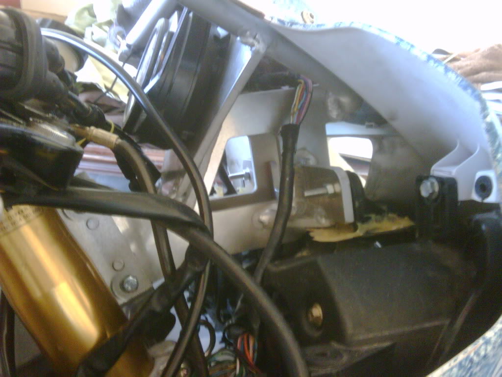

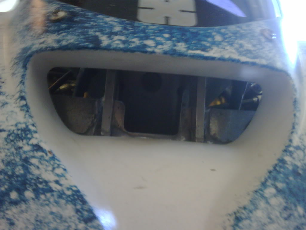

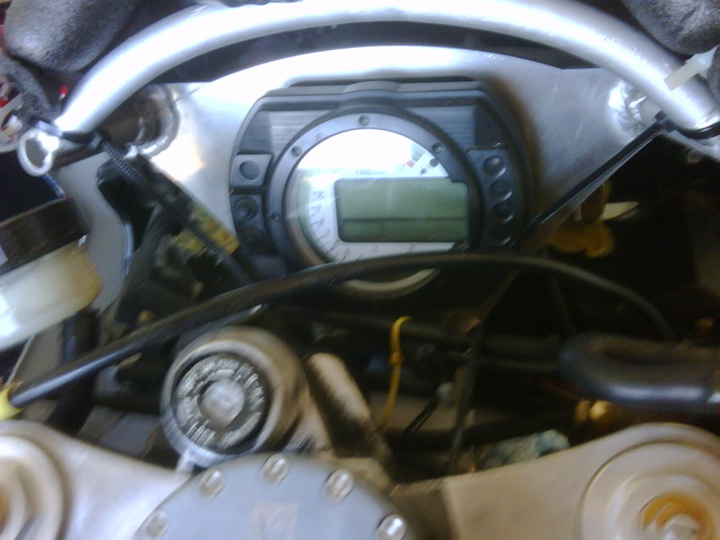

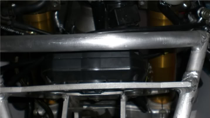

man I still have mine and its holding stonger

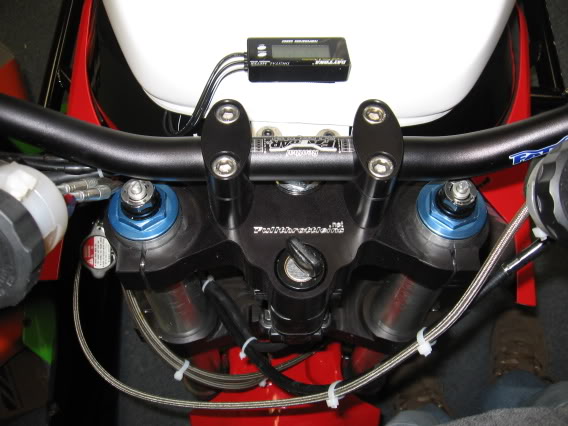

09 is 53mm so you would have to bore them out .5 to fit 54mm forks
FTI made my friend a custom billet bottom triple for his 954 a few years ago, it was really nice but he payed like $350 for it and waited a very long time for it to be made...
You can just see it in this pic
