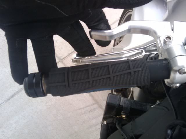

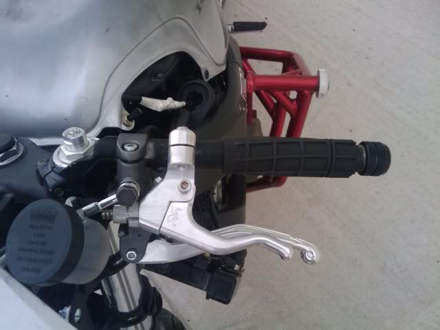

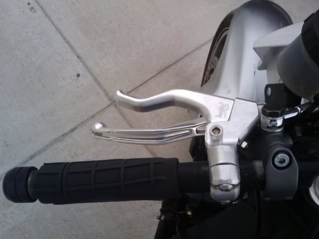

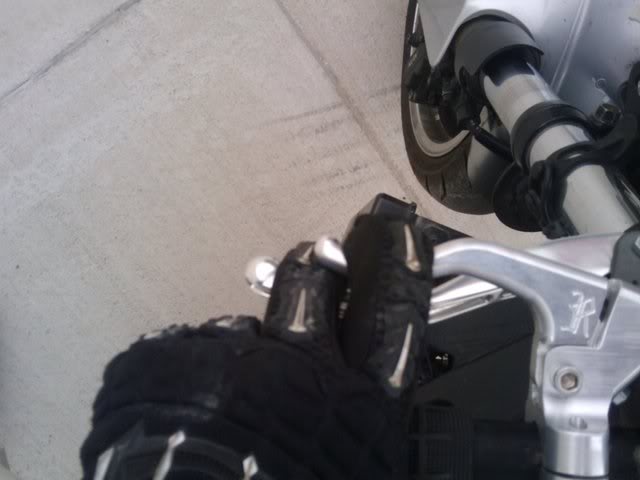

For all those that wondered how this clutch would work with the magura...
It works ok with the magura but not very well on stock clipons because of its beefyness.
My problem is I dont have db bars or aftermarket clipons.
I had to run my clutch on the outside/handbrake on the inside.
Because my bars dont have enough length, as you can see my hand mainly holds onto my bar ends.
That is not the case with an MSR or Moose, and pushes the magura way too far out on the inside.
Other than that, the angle and throw of the lever works out well.
The delrin bushing feels better than the copper one, copper started sticking after a days riding..
The new angled perch is perfect, dont even need the stop screw.
All in all, I think the perch is still a little beafy near the adjuster..
I am happy with my setup though, cant wait for some vortex or FI 0 degree clipons.
