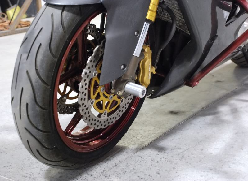

What lengths do you guys prefer on front axle pegs? We have made a few sets, but I dont run them so I dont know what length everyone prefers. They are available smooth or knurled (grip) Thanks in advance.

Ive been told by a few other riders that the shorter the better. Basicly long enough to get your foot on.. Im 100% open for suggestions. Anyone have a length in inches they prefer on the pegs?
F4i's are ready too. Just let us know the length.

Longer=they will break or bend the threaded rod that holds them on. I agree with "the other riders"

I would like a lil longer.. Thats only from tandem stand point. And yes very soon SI will have everything u need

and always knurled

do these protect anything when i drop my bike or only good steping on and stuff?
They help protect the rotor and rim when the bike is dropped.

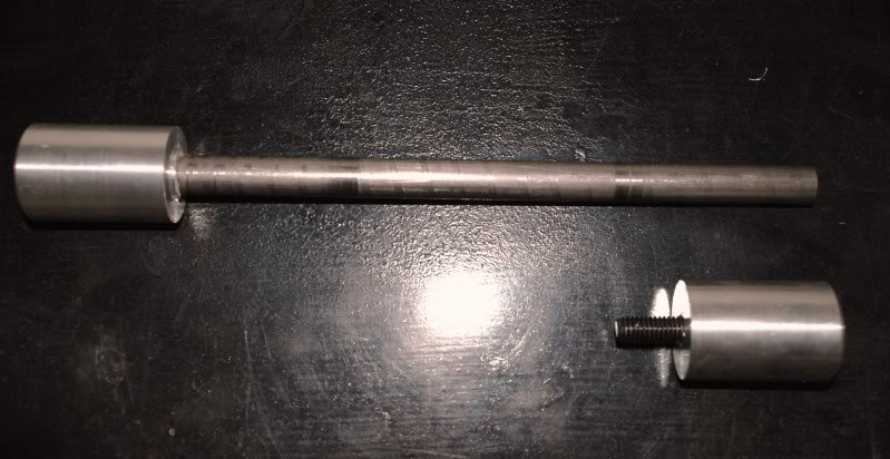

They are VERY stout. We are using a solid 9/16 rod thats threaded at each end. I feel shorter would be better, but We will offer differrent lengths if anyone has a specific length they want.
Sweet jesus. I was thinking allthread.

1 inch & 3/4 to 2 inch max would be ideal. DEF knurled Enough to get ur foot on for burnout combo's but not stickin out enough to get snagged while drifting at max lean angle or bend things like axles from pancaking.
