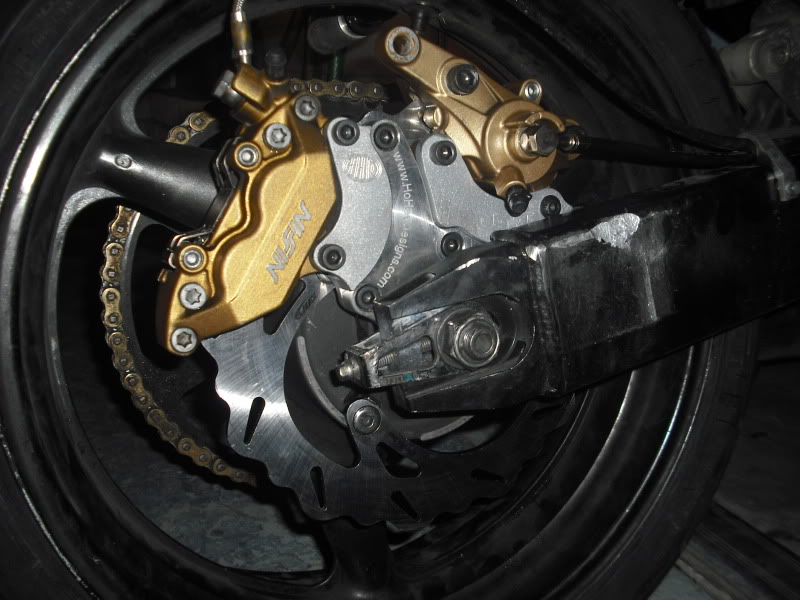

Re: new big rotor from hoe hey
HHD Big rotor kit for New Cbr RR
