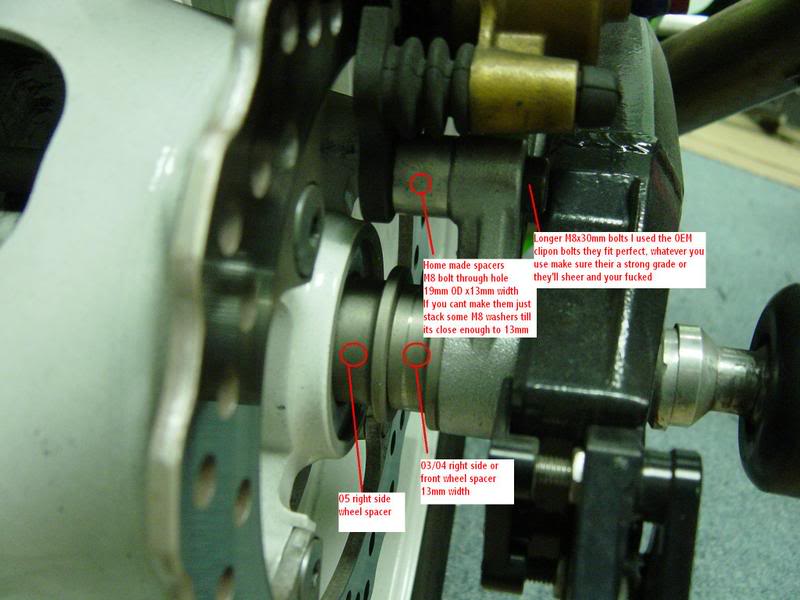

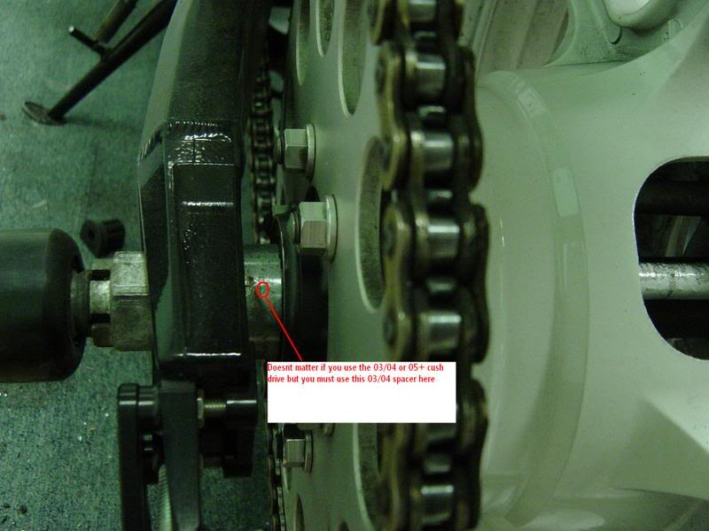

Its been a while since I had to use these pics

ho hey sells the spacers also. It's not much work at all. the 05/06 rims are sweet lookin

Actually it's the same width 5.5"
People do it for the looks... only other difference is it's a bit lighter... while at the same time slightly weaker... seems like they are a bit easier to bend than 03-04 wheels...
good mod if you do the swingarm also... otherwise you're better off just leaving the 03-04 stuff on there
