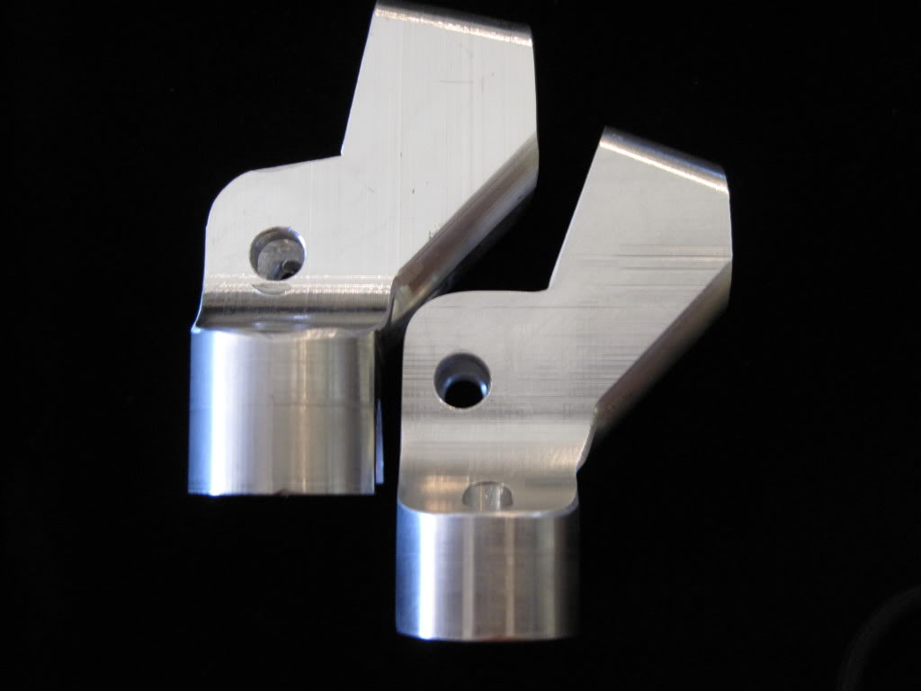

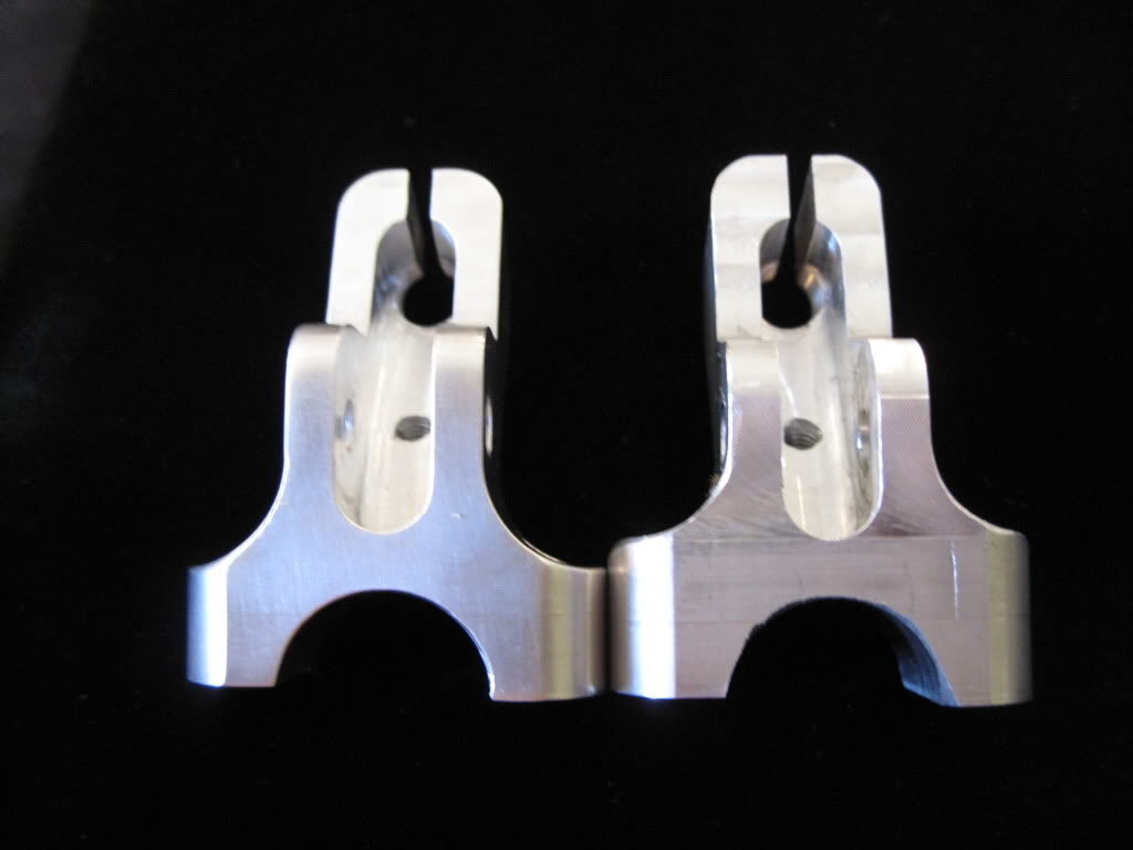

Sooooo.......here's a few pics of the changes made to the original(flawed) perch that was sent out originally. As you can see, we shaved down some of the bulkyness of the perch clamp area to accomodate more setups. Also, we cut the correct(deeper) angle into the perchs to allow the lever more travel as well as distance to the bar, giving it a stance VERY similiar to an MSR. I have also changed the bolt/bushing design. After a little more R&D, we have decided to go with a Delrin bushing that more or less presses into the lever and rotates on a "shoulder" bolt. Delrin is a somewhat "self-lubricating" material similiar to Teflon. This will ensure that the tolerances of the lever bore will never change due to use w/ a metallic bushing. The Delrin bushing gives the setup a very "buttery feel. I have sent all redesigned perches out with a new bolt and TWO new bushings. We haven't had enough time to test the Delrins life expectancy in this application. The initial tests seem very positive for a long life expectancy. If this isn't the case in the long run, I will send out a replacement press-in metalic bushing. Allthough the Delrin is somewhat "self-lubricating", I recomend using a silicone based spray lubricant to keep things smooth and silky. I'm excited to start hearing about everyones thoughts and experiences with this new and improved design.

are those the old ones re-machined or new ones?

i "think" they're the old ones re machined

They're actually new ones. He had only made 25 when we found out the original problem. He says he can remachine the old ones when we get them back.....so far I've only gotten 3 out of 22.
did you hook one up to your bike to test the travel distance of the lever? and any final pics of the whole setup?
Yes! It's VERY similiar to an MSR.....the way my prototype was.
