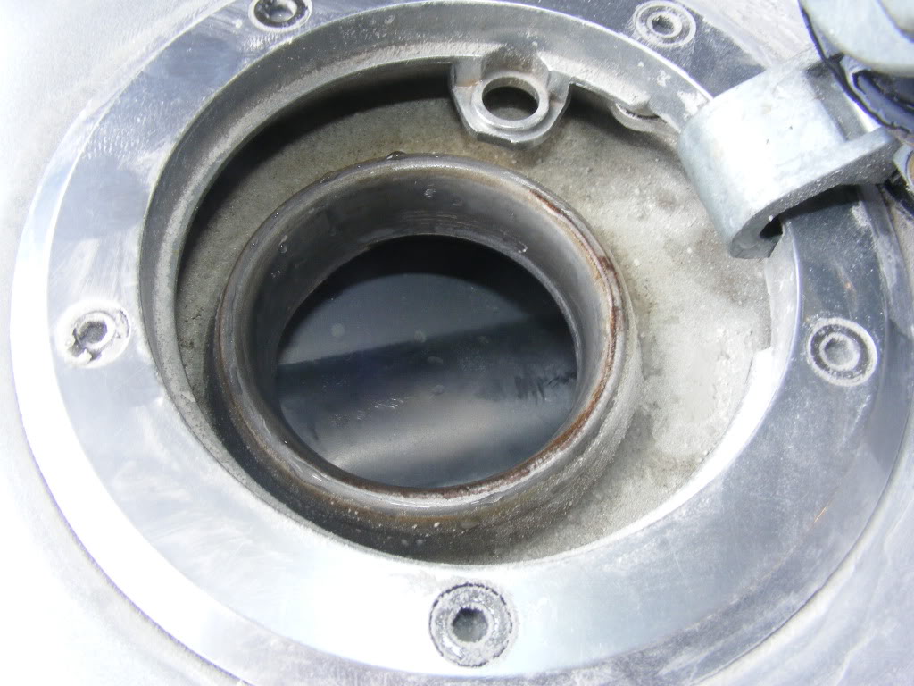

this is my 3rd dent but by far my deepest but i ran into a problem that maybe someone can help me with. How the hell do i put gas in this turd?????

uhhhhh.very slowly I guess,maybe you can dent down the inner part of the tank enough to get a gas nozzle in there
Old Sep 17, 2009 | 02:12 PM
vegasrider2005's Avatar
MVS
Joined: Apr 2008
Posts: 1,101
From: Groveton NH
Re: new dent help
ya i was thinking slow was ganna be my only option, but just didnt know if i missed something along the way. ha ha o-well
Old Sep 17, 2009 | 02:17 PM
Dilts646's Avatar
Joined: May 2006
Posts: 1,820
Re: new dent help
Ya you should have cut that splash guard out before denting the tank! Try cutting it out now.
Old Sep 17, 2009 | 02:18 PM
MVS
Joined: Apr 2008
Posts: 1,101
From: Groveton NH
Re: new dent help
o yeah this bike is F/I it has a big hole in the bottom of the tank, ha ha im such an idiot, ok be back in a few
Old Sep 17, 2009 | 02:30 PM
Dick Loogie Stunts's Avatar
www.myspace.com/impaktech
Joined: Mar 2008
Posts: 4,235
From: FAR NOR CAL
Re: new dent help
+1 on cutting the splash gaurd cuz then your cap part will go down flatter with the dent and you can fuel up easily but it is a pain in the *** so i just bent part of the splash gaurd up with a flathead screwdriver and i can fuel up at a near normal pace

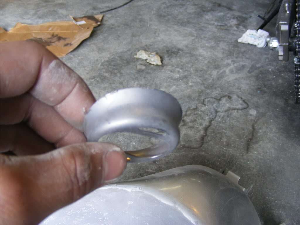

No idea on the damperner, there are now stickers or anything on it and here ya go..
just took a dremal and ran it arount the edge and it popped right out

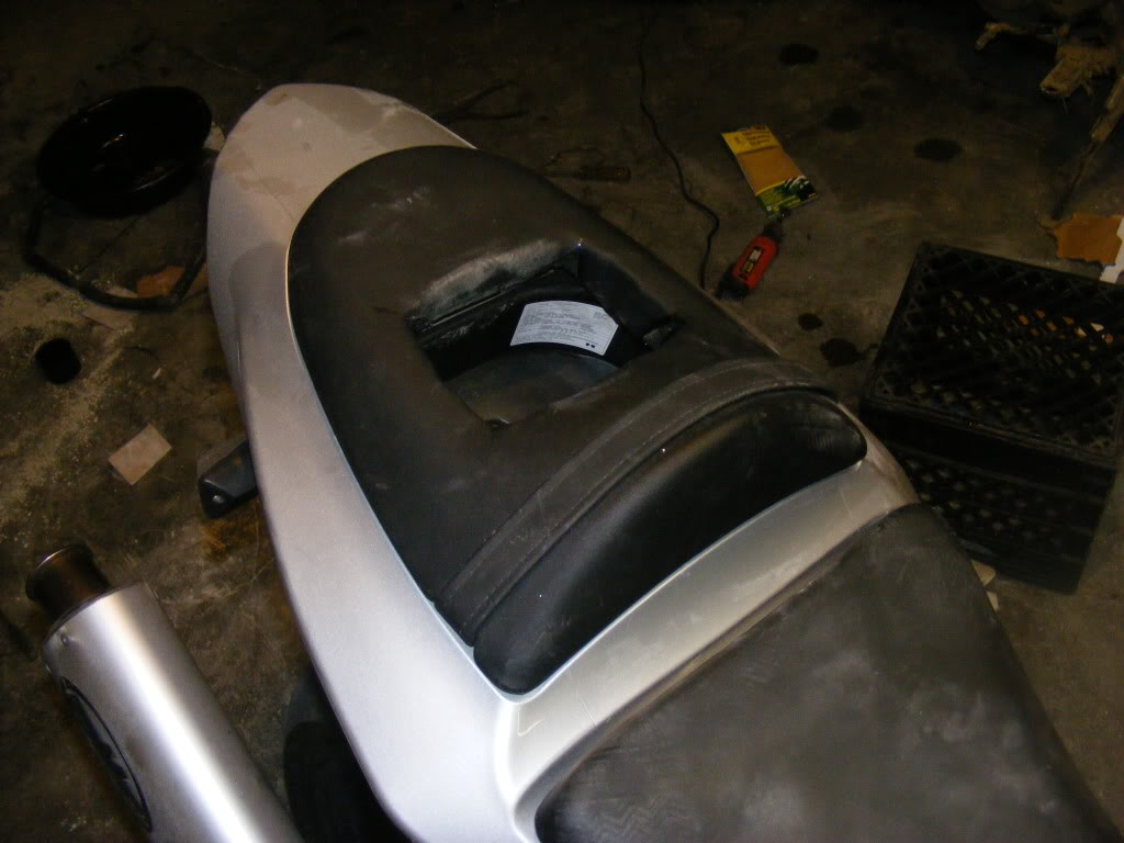

you dummy that just thebox under my seat ha ha here is my seat
