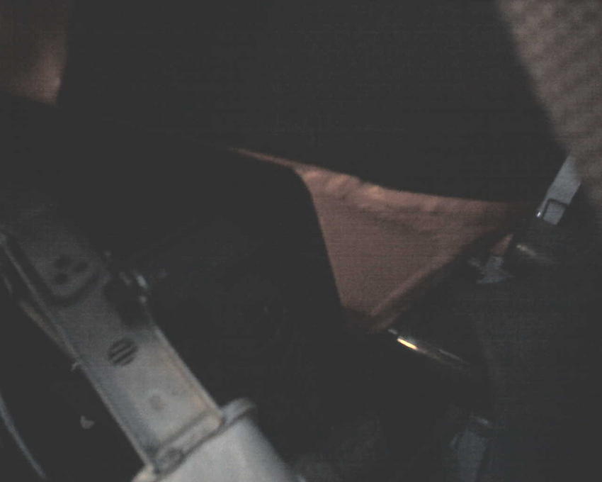

I don't have any pictures but I used a method similar to kyles but didnt wrap around. I actually used plate as a gusset and ran it at a slight angle to strengthen from impact. I'll see if I can get a pic tonight.

Not great pics but all I could manage with my phone for now. Basically used a gusset that is welded to the motormount but also follows the main part of the frame as well. I figured this would provide more strength from impact. I did the same on the opposite side but can't get a good pic without tearing off panels.
