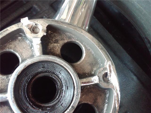

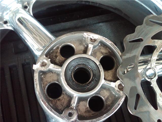

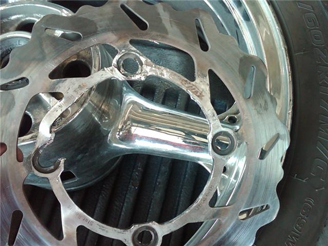

Rotor bolts snapping?
Came out of a drift this weekend, hit the brake to slide and CLUNK!!

Thats a STAR brand rotor, the same ones Hohey sells
And I highly doubt that all the bolts just snapped on their own under braking, I bet one came loose backed out a little and the head got caught up on something...Im sure if you look around your caliper bracket, there is probably some damage where the bolt got caught up....
There is more to this then simply sheering all 3 bolts at once, look at how the rotor has been streached out of shape...That leads me to believe one bolt got caught up on something

It's a single sheer load. I agree there is no way they all just snapped. The holes in the rotors had to be ovaled out and impacted the bolts over and over. The streching out of shape could be when 3 of the 4 bolts were sheared and the rotor got hung up on something and pulled the last bolt through. I wonder if the holes in the rotor are the right size and if the rotor material is heat treated properly. It looks like the material is way too malleable (soft).

Idk. Maybe the bolts backed out a lil then it broke? It snapped 3 bolts off in the rim,I drilled them out already
So I think the rim will be fine. I slam that rear brake a lot when I drift and the rotorhas been on for over
A year. Upgrade to the HoHeezle big rotor kit I guess
More than likely they backed out and started oveling out the holes. Then the repeated impact of slamming the brake finally did the bolts in.
