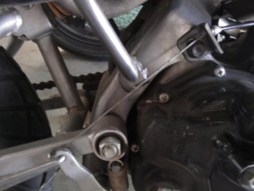

i just ran a bycicle brake cable down and made a bracket that'll hold it and the cable goes through the hole for the cotter pin. i'll post a pic.

maybe the cable is stretching? it'll lock up with foot brake.

Yes really , cuz you no nothing about stunting , yes you need a better handbrake . want me to teach you how to ride the bike too ?
But on a serious note .
The swingarm looks square with a little fab. work you can make a perch .
After that get a handbrake cable for a atc200 "it's oversized & long enough" .
Next step if you can't lock the rear wheel up is get a msr e-z-pull
After that sand the inside of your hub & lightly sand the brake pads
case closed... bring on the next one .
