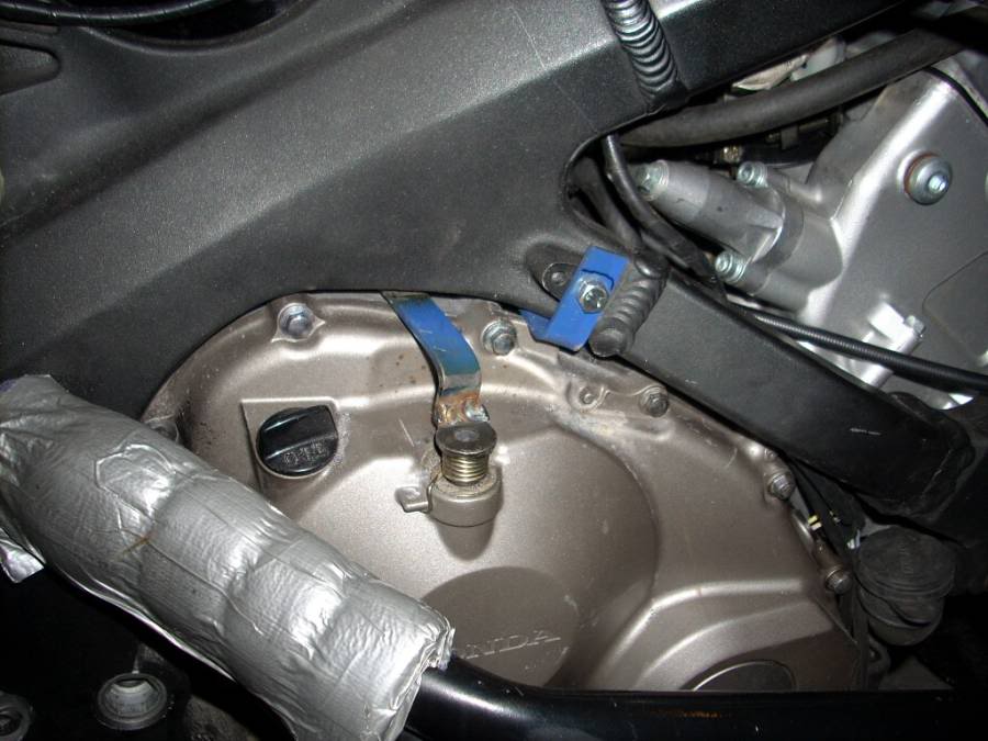

And just in case you wanna go crazy and get an easier pull you can do the clutch arm mod but its not as easy as the F4i or 636 Here's a pic I found online of the R6 clutch arm. It sits right next to the case so you have no room.
Here's a pic of the clutch arm mod done to a 600rr which is similar in that theres no room. A guy from SUSA made this crazy contraption. I heard at first that he liked it and it worked well but Ive since heard that he got rid of it but dont know the final result
Im sure you could ghetto rig your **** somehow like this guy did and even though ghetto rigged, IMO it'd still be A LOT safer than using that moose pulley system
