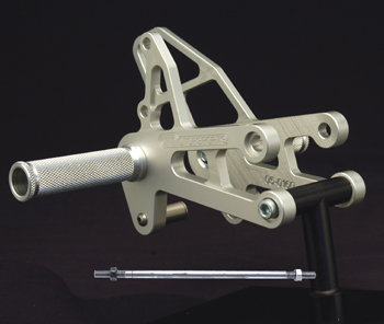

pics of the woodcraft ones that take stock pegs
http://www.naarden.biz/store/FP%20Vi...rset-Woodcraft

The rear brake pedal pivot will break right off the rearset bracket cuz it's soooo small.
Go Hohey. My bro, Chris, Broke his off just warming up. Mine broke when i got it. Not a foot peg problem but a safety problem. Get Hoheys before you're a victim.

screw everything else.......go with the hohey rearsets they are bulletproof
www.hoheydesigns.com

i had that same problem every so often, then i got the woodcraft ones... Boom!! problem solved... i did get my old one welded but they are just a back up in the event i need it...
