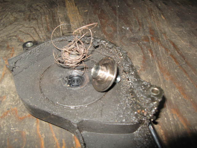

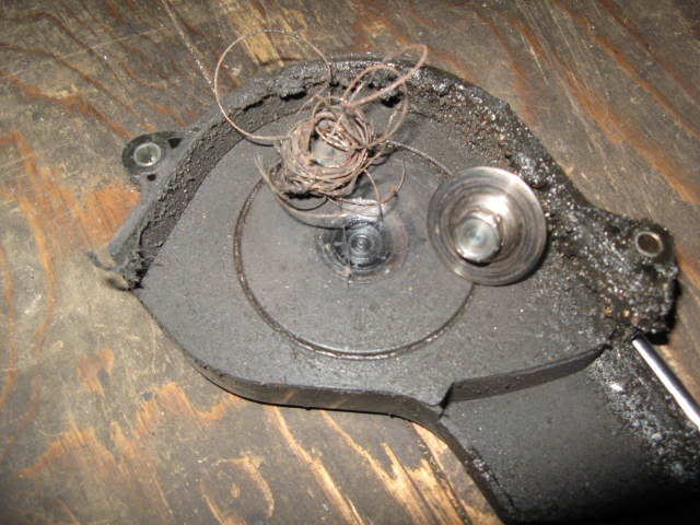

Just a reminder if you have tires with wire canvas to remove your front sprocket cover and there could be wires in there too. I did 3 or 4 tire blowouts before removing the case and noticed a big slump of wires tangle up in there was eventually gonna wear out all the metal. A few months more of riding and I would have had to use something different than a socket wrench to change the front sprocket

haha nice, im gonna have to double check that

thats interesting. never had that happen before or heard of it happening til now. thanx for the heads up. good post

WTF! Are you running bias-ply trailer tires???????

not sure but could be Bridgestone Battlax BT ..

You gotta actually blow tires off to see cords
But really, some tires have metal cords, some have cloth cords

yeah cloth cords are easier to clean but metal cords can cause damage, I had no clue there was some stuck in the front.

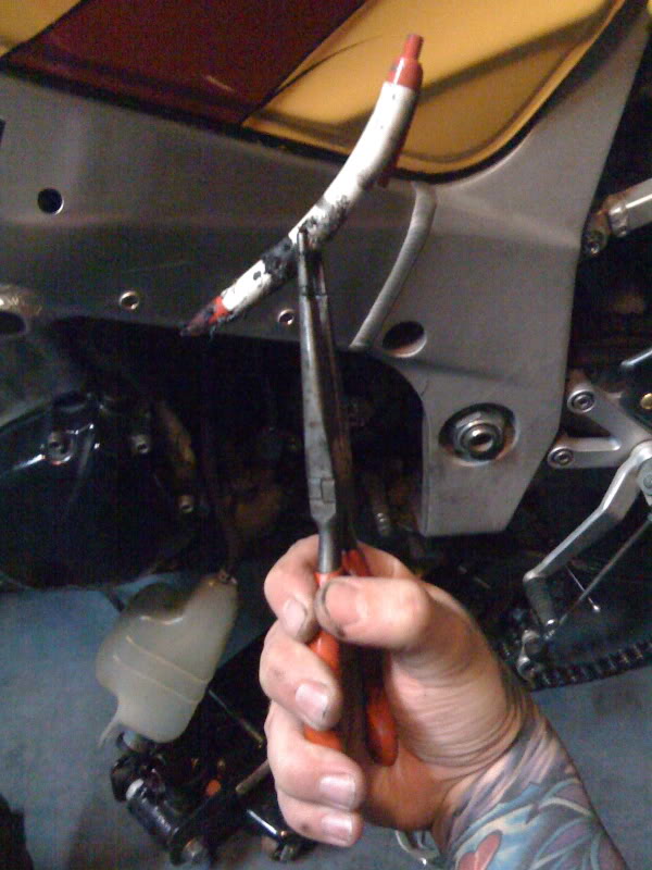

Or you could find a pen?!?! LoL when I got this bike, I went to change out the sprockets, and found this next to my front sprocket........

******* rediculous. lol thats funny tho

There ya go, another reason to take the cover off once every few months. You never know what you can find in there, wires, pens, fingers, who knows?

nice thats crazy
