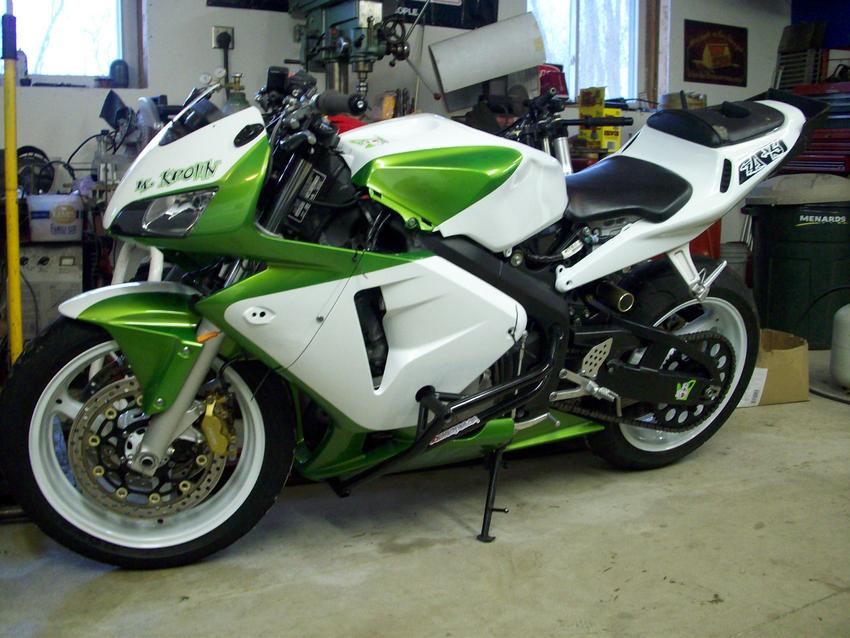

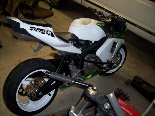

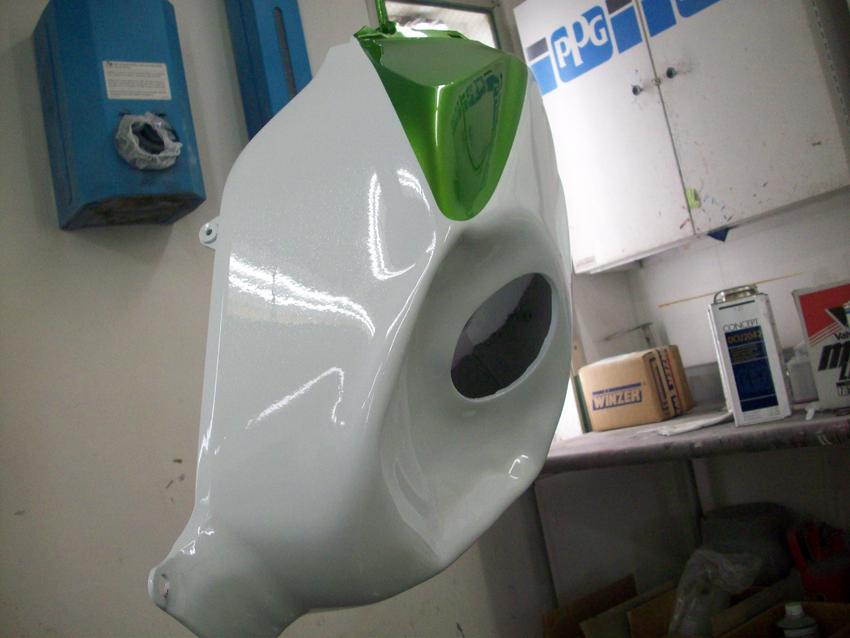

Take the tank cover off, pound the metal tank to where you feel you want it. I little wider because you will have a thick layer of plastic on top of it.
I used a torch VERY short heat sessions and pushed it down with a towel over it so i didnt burn my hands. It takes time and dont over heat it or you will bubble the paint on top. The underside you will char and crack but you wont see it up top. I spent alot of time on mine doing little by little but it is butter smooth and looks great.
TAKE YOUR TIME!!!!

Old Apr 2, 2009 | 04:20 AM
Re: 05 600rr bang in gas tank
TAKE YOUR TIME!!!!
Nice job on that man... Bike looks sick..
