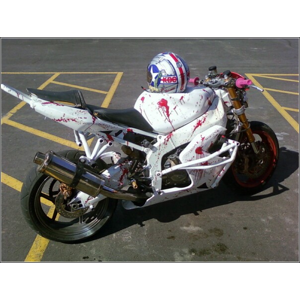

here is my beast.. spray bombed anyone have a front fender
wondered how people sprayed out of can and got the splash look?? due tell... looks sick! only thing I hate bout spraying from the can is you get it looking ******* great but some gas spill or a good paint chip and it feels like i went thru all the work for nothing
