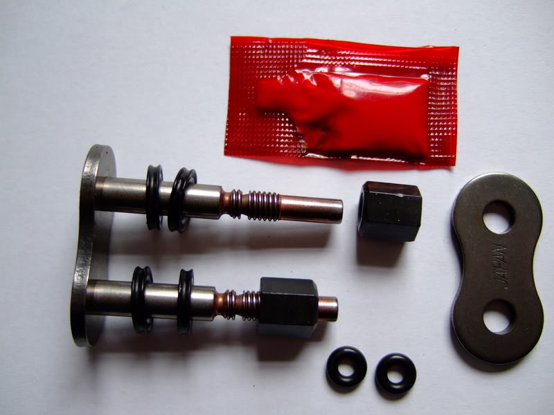

I found a link made by EK called a "screw type" master link. They cost about 10-15 bucks, but I think it is well worth it. its a pretty simple concept. here is a helluva write up on them.

if you get some time later, go to te link i threw in there...the leftover threads that act as a groove for those o-rings are perfect for a 5/16th nut with 10-32 threads and some threadlock. as for the dry rotting, i dont see that as a problem. well...not if you take care of your chain and keep it lubed and all.
here is a dude with over 8000 on his, and it still looks fine
http://www.klr650.net/forums/showthread.php?t=24044
im gonna stick with the screw type til it ***** me over. easy as hell to install. dont have to worry about the clip popping off. even if one o-ring pops off, i still have the other o-ring. and i dont have to pay 100 bucks extra just for the tool to do the rivets because im retarded and cant figure out how to do it without the tool.

the screw types are just rivet masters that rivet them self via the screw
at first I though it was one you could take off... But nope its riveted on
If anything just go with riveted or go with clip style, thats my 2 cents

i thought the oring held it on , how does it rivet it self ?
The Screws Basically Press it on. Kinda like a Rivet type but different. Its a good concept but I have never had anything go wrong with a clip yet so... im sticking with it for now. Maybe next time I buy a chain I will check this out though. Looks really well designed so Im not to weary about it.

I read the threads and looked closely at the pics and I still dont see what holds the plate on. The guy in that one thread bought some nuts to hold his on, but if they werent there i dont see anything.
Did you guys see how he was trying to pry it apart with a #1 flathead? He couldnt even pry the scabs off his dick with a screwdriver that small.
To do rivets, you dont need an expensive tool at all. Big C clamp ($5) and a nut to press the plate on, then 2 big hammers (one behind the chain) to mushroom the end of the pins.

so it's an interference fit not a rivet , i would not trust my life to an interference fit ...the little orings must be a back up and thats because they know the interference fit will fail eventually

Ok, let me chime in hear as I have been rocking these links on 2 different bike's. One bike has had well over 6 months use and I go to the lot 4-5 days a week for 4-5 hours a day if not more.
The other has maybe 3 months use and they have never given me a prob and I RIDE the **** outta my bike's.
OMR, what you do is put it all together then tighten the nuts and they crush the stud/threads into a mushroom head almost just like a rivet. Then all you have to do is sanp off the nuts as they break clean off from where they are tapered. I belive what gets mushroomed is the lower set of threads as it breaks off just above that when all is said and done.
I love these things, easy and fast. Kinda like death speed circs lol

Just like stated above...its not different than a press on link. once the plate is pressed on, you break off the excess along with the nuts. Its just like a press on, but without the requirement of special tools.
