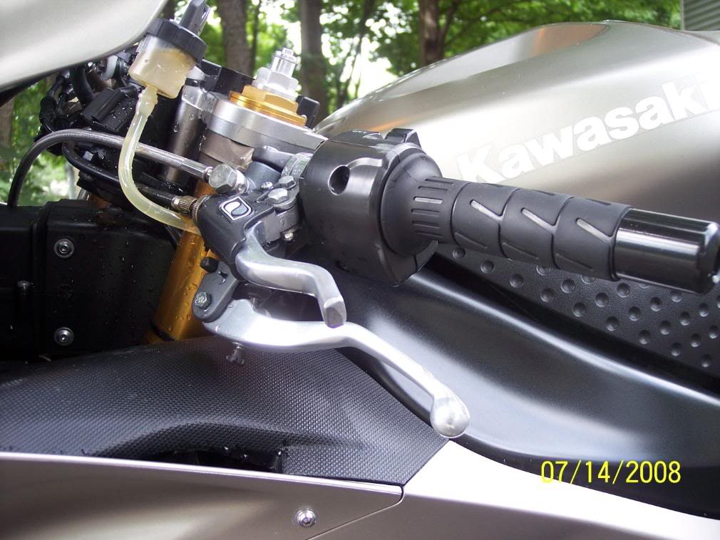

i have stock clip-ons and am trying to keep my bike streetable anyidea where to put the switches so i can still use them (pics would help)

im not sure if your clip ons are similar to the 636 ones but. you can keep all your **** on there if you use an msr or moose clutch lever with mots any radial mc. all i do is cut about 2mm off the end of my grip and everything fits perfect.

your pics didnt load on my end but i got the Full Throttle universal setup but ill try cutting my grip and see what happensthanx

nevermind they loaded now but my bike wont run without the clutch pluged in it just clicks at me what did you do about that

start it in neutral. or you can cut the clutch switch wires and splice em togther, but then the bike will start while in gear and with the clutch engaged

alright i just tryed to unplug the switch and it still clicks evan in neutral. so im ganna have to cut the wires. There are three wires do i splice all three together or two anyway anything will help
